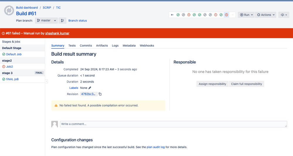

You can look at the Buildresult of that run and see what stages passed and what failed, in this particular run, we can see Stage 2 Job 2 failed and Final stage was run successfully.

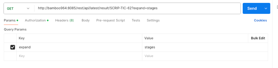

You can use the REST API to get the details, refer api-api-latest-result-projectkey-buildkey-get for more details.

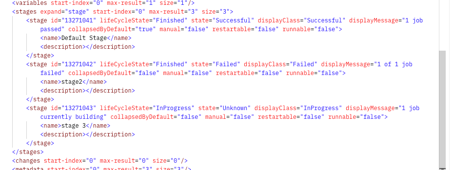

You'll need to use the expand parameter for stages, see example below
The result would look something like below when you expand the stages, it would print the status of the stage and you can see if your previous stage was successful or failed.
