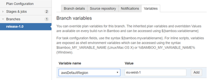

As long as you are only using long lived branches as outlined, you should be able to just use a single plan, create a manual plan branch, and then override the variables in the plan branch details configuration:
This approach seems to be working well. At the moment, the main plan is referencing the develop branch and I've created a plan branch for the master branch.
I'm toying with the idea of removing the repository from the main plan, so that it never directly triggers, and then adding the develop branch as a second plan branch. That seems to be more consistent than the way I've got it configured at the moment.
Just as a follow-up note, it is perfectly possible to remove the *trigger* from the main plan and add the develop branch as a second plan branch. It works well and BitBucket still recognises that a pull request against that branch is building even though the main plan isn't the one building it.
Thanks for the follow-up @Philip Colmer, using plan branches without the main plan is a neat approach I never even considered!
