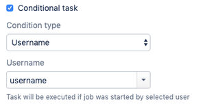

When checked this will allow two possible configurations:
  1. Select which user should run the build as a condition for this task to run

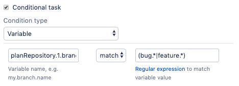

  2. Select which plan variable of global variable will be checked to decide if this task will run or not
⚠️This will not work with injected variables, but only with plan or global ones.
⚠️⚠️The name of the variable does not include bamboo at the beginning.
e.g. the variable bamboo.planRepository.1.branchName should be added as planRepository.1.branchName.
The example of configuration shared will only run the task if the branch name starts with bug or feature.
There is no notification when the task is not run, but in the build logs you will see something like:
simple 13-Jun-2019 15:29:56 Found conditional task: com.atlassian.bamboo.plugins.scripttask:task.builder.script . Skipping task because conditions were not met.
In this case, a script task was skipped because it was configured with a condition that was not met.

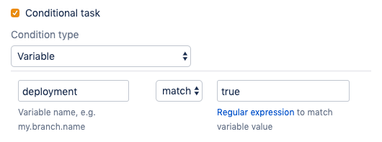

I tried the conditional variable which I defined in the plan did not work either.  I defined the variable "deployment=true" and used it as "${deployment}" for the condition type and
control new release as "${bamboo.deployment}==true"
The error that I got:
Condition com.atlassian.bamboo.plugins.bamboo-conditional-tasks:variableCondition wasn't met. Skipping task.
Thanks,
Ieng
Daniel Santos
September 16, 2019
Hi @Ieng Lao
You should use just "deployment equals|match true".
