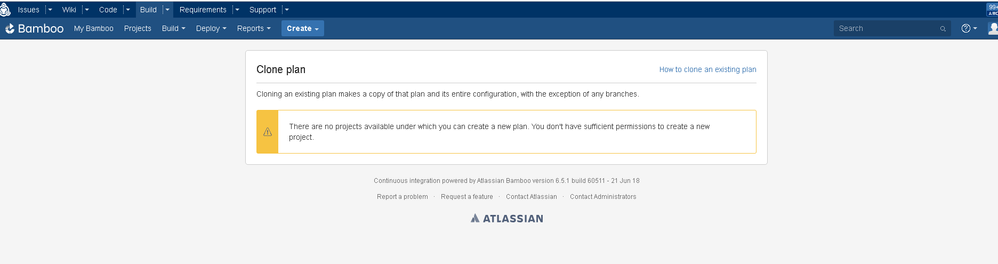

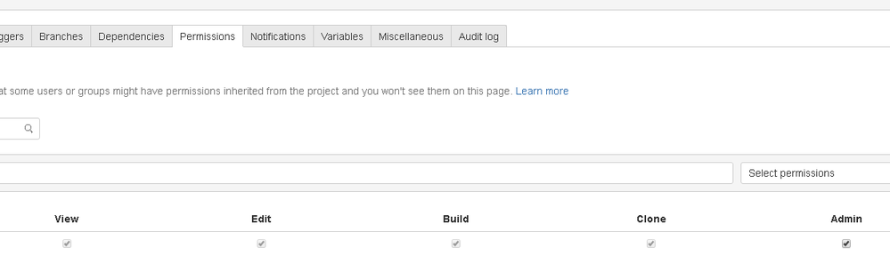

When I am trying to clone the master plan, here is the error that I am getting. how do I resolve this?
Also, The permissions tab does show that I have permission to clone the plan.
image.pngAny thoughts?
Foong
March 5, 2019
The missing permission is in the Project side.
The Project Admin will need to add Create Plan permission for you at Project settings (for the related project) > Project permissions
Configuring project permissions
Like Heena Agrawal likes this

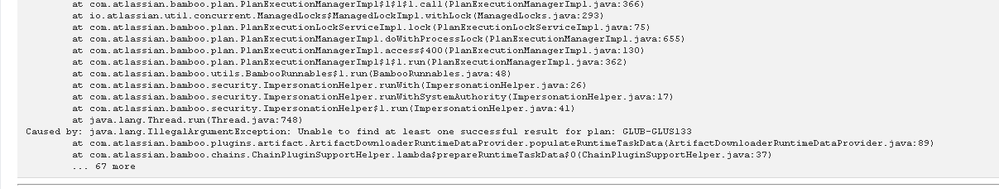

However, when I try to run the branch form the plan that has the "Artifact download configuration" task, I receive the following error. Any suggestions please?
Heena Agrawal
March 5, 2019
Never mind. I had to run my default branch again to straighten out some issues there. After that the new cloned branch works fine and the artifacts are shared perfectly.
