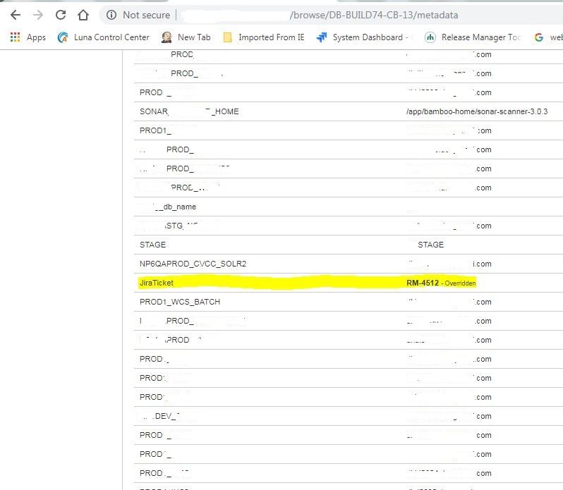

Hello @Daniel Santos  i want to pass on a custom metadata to the deploy job how can i do that.  i have intentionally removed few of our other variable parameters. I want to use the Jira Ticket # in a deploy job.Capture.JPG

Hi @Abhishek Mozumder
Do you want to run the deployment, but customizing the variable when starting it?
Or do you want to inherit the customized variable from the plan metadata?
If you want just to load a custom variable from a build plan, you should just reference it in the deployment. It should be able to use it as:
${bamboo.JiraTicket}
But if you want to run the deployment with a different option that will allow you to change the variable right at the moment the deployment is started, then you will probably need this add-on: Custom Deployments for Bamboo | Atlassian Marketplace
