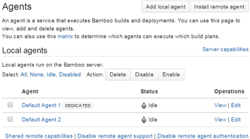

  1. Go to the Agents management page - all dedicated agents are marked as such:

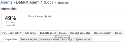

  2. Go to the agent in question by clicking its name or View.
  3. Click the Dedicate agent button, which happens to also be the dedication management page:

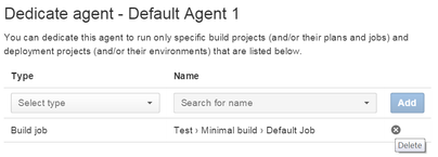

  4. Click the Delete icon on the specific dedication you want to remove:

You can go to Administration > Agents.
Click on View link against Agent name in a list of agents. Then click on Dedicate agent button. There you can see list of jobs and deployment environments assigned to agent
