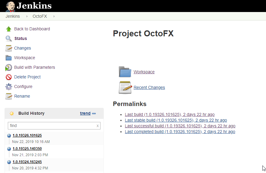

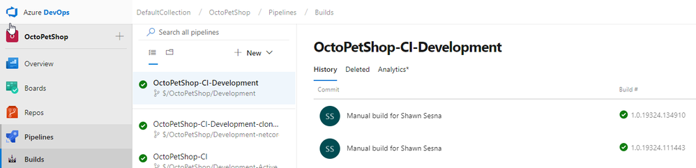

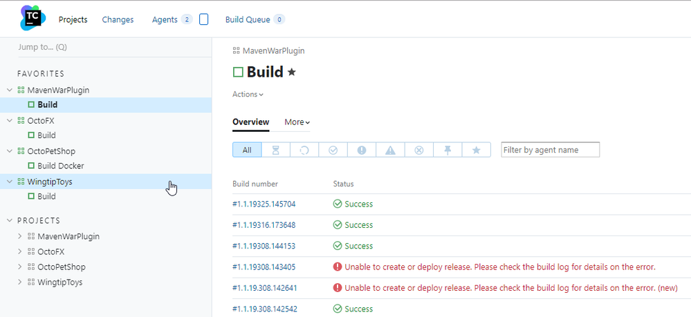

In other build platforms (Azure DevOps, TeamCity, and Jenkins) we can rename the build display to be a version number such as 1.1.351.4.  This version number can get stamped on artifacts such as NuGet packages which can then correspond to release numbers in Octopus Deploy so it's easy to trace a release all the way back to a build.
I've included some screen shots from the other platforms to help illustrate what I'm trying to do.ADO.pngJenkins.pngTC.png
