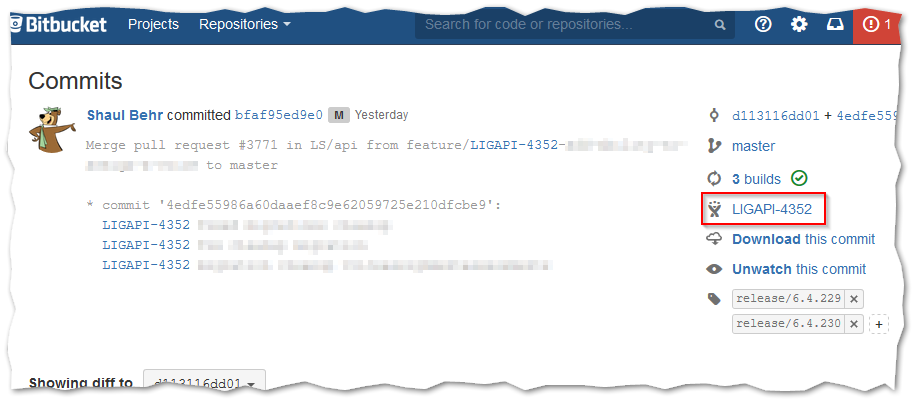

So I found this API being called in Bitbucket:
/rest/jira/latest/projects/LS/repos/my-proj/pull-requests/3772/issues
That's the kind of endpoint I'm looking for, though it's not exactly right, because this gives the issues per pull request, whereas I want the issues per commit. This also must exist, because I can see it on the "commit" screen, as highlighted below:
I looked in the developer tools and couldn't find the call that returns the issue numbers related to the commit, though.
What is the call?
shaulbehr
July 11, 2019
Got it! It's this one:
/rest/api/1.0/projects/{projectKey}/repos/{repositorySlug}/commits/{commitId}
At the bottom of the response is:
"properties": {
"jira-key": [
"LIGAPI-4352"
Thanks for your help!
