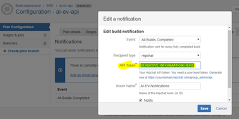

But the scenario or the use case that I am looking for is slightly different. Its not a sensitive plan variable that I am trying to update, but instead its an API key under the notifications tab under plan configuration that I am trying to update via bamboo java specs.
Please find the screenshot for your reference.
Any help in this scenario is highly appreciated

I see what you try to achieve now. It's not supported functionality. HipchatRecipient doesn't support encrypted values for api token. Created https://jira.atlassian.com/browse/BAM-20236 to keep track on it. As you know Atlassian is gradually sunsetting Hipchat and Stride so I don't expect it will be addressed in nearest future
But this API Token field supports Bamboo variables, so you can create plan variable hipchatSecret with API token value and then set '${bamboo.hipchatSecret}' value for API Token field at Bamboo Specs.
Give it a try and let me know if it works for you

January 10, 2019
Thanks Alexey. This definitely helps.
