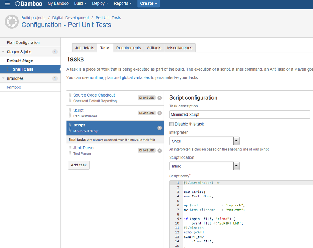

Thomas Leitner
February 27, 2019
We use Bamboo version 5.14.1 build 51413 on a RedHead 2.6.32-431.29.2.el6.x86_64.
The Job has no specific setup. All tasks except the minimized script are disables (no code checkout, no testrunner, no postprocessing):
The job fails and the log file is:

Thomas Leitner
March 6, 2019
The problem seems to be located in the .cshrc of the user starting the bamboo job.
Unfortunately I do not have access to that user setup files.
Thanks for the support. The remaining is an issue I have to discuss with our Bamboo administrators.
