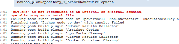

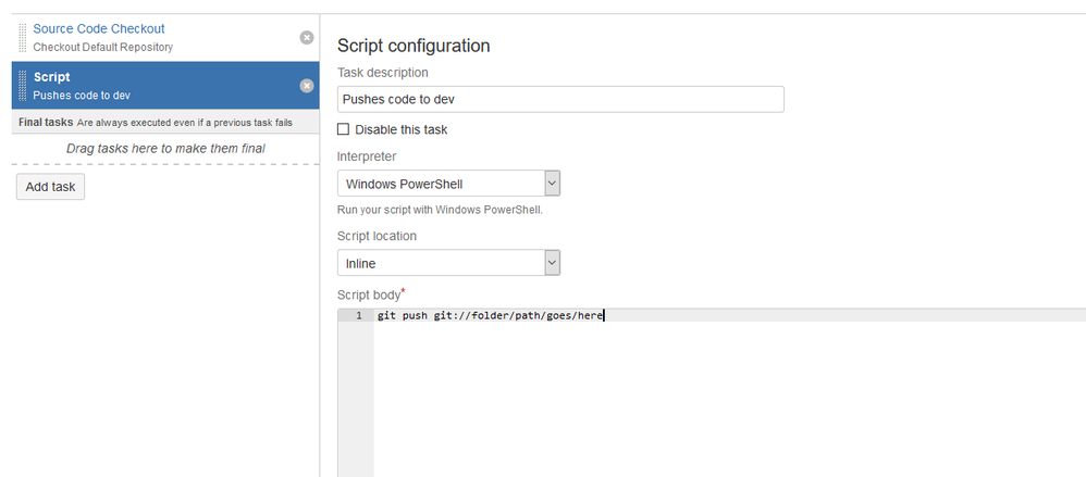

This is where I get stuck. I created a script task that uses a git push command but for some reason, bamboo is not allowing the git command to work. I tried the following:
  • writing the command inline
  • placing it in a batch file
  • I tried including the $ before git and not
  • I tried powershell, shell with a bash shebang, and cmd.exe to no avail
I think I'm missing a crucial component but don't know what I don't know. Any help would be greatly appreciated.
Screens below show the log and how one instance of the command is setup.2018-09-13 08_08_39-Gallery of Guns - GOG Development - Push to dev_ Edit job configuration - Atlass.png2018-09-13 08_09_48-Gallery of Guns - GOG Development - Push to dev 11_ Build log - Atlassian Bamboo.png

Hi @davidsons ,
The ideal way to deploy your code to a server is using a deployment project in bamboo with scp tasks to copy your source code to the server.
When you use Source code checkout task, that will bring all your source code in to the bamboo build directory. Now you can use a SCP task after that to copy instead of using git push. It is not required to install git on your destination server.
More ideally , you should create an artifact of your source code in the bamboo plan, then create a deployment project which will pick this artifact and deploy to your destination server using SCP tasks. That way you can use this artifact to deploy to multiple environments configured under deployment project and it`s also preferred method as it is easy to trace back your releases compared to doing SCP with in the bamboo plan. You also get a rollback option by using deployment projects
Hope this helps

Edwin Kyalangalilwa
September 13, 2018
Hi @davidsons,
The issue is that Git is not in the path. Please confirm that you can run the git command manually on the server. If not, then check your path.
davidsons
September 13, 2018
Hi @Edwin Kyalangalilwa
git is in the path already and can be run manually on the server
