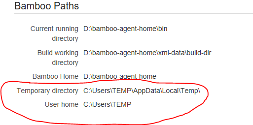

The system properties of the bamboo agent is attached.  The problem is circled in red.

Hi @Hector Magnanao,
That is the temp directory and you can updated it by:
  1. stop Bamboo remote agent
  2. edit <bamboo-remote-home>/conf/wrapper.conf and update property to point to the chosen location in filesystem:
    wrapper.java.additional.X=-Djava.io.tmpdir=C:\Users\TEMP
    where .X is the following number in sequence
  3. copy <bamboo-remote-home> to the location specified above
  4. start Bamboo remote agent
Kind regards,
Rafael

When I tried to set that variable to C:\Users\3_bamboo in the wrapper.conf file, the User Home is being set to C:\
I would like to set User Home in that window to C:\Users\3_bamboo
I believe that if I can set the User Home to this value, then the temporary directory will also be set correctly.
How do I set the User Home directory in that conf file ?

output for temporary directory:
Temporary directoryC:\Users\TEMP\AppData\Local\Temp\
