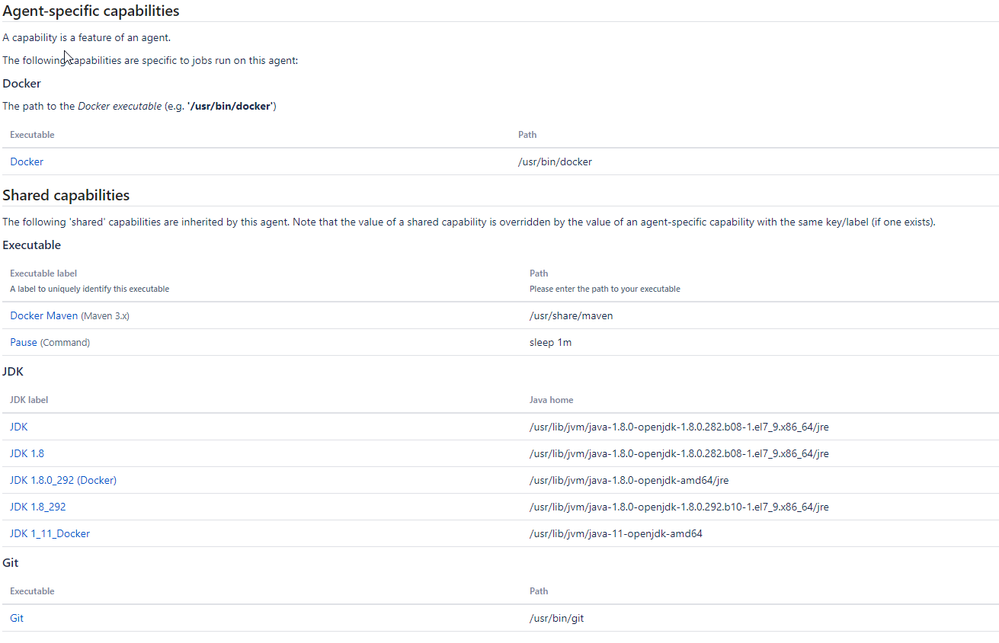

Gonchik Tsymzhitov
April 28, 2021
Hi!
What environment options did you configure for agent?

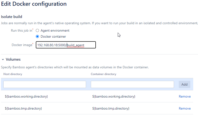

PeteSmith
April 28, 2021
To be honest - I don't know.
I set up the plan, selected "Docker", entered the fully qualified local registry name (192.168.80.19:5000/build_agent). It's got the default shared volumes (Bamboo temp & working directories)
The agent config itself is pretty much the default.
I've added a Docker capability to this agent.
The JDK and Maven paths are common to the agent and host, so they're shared
Does this help?
Thanks for your assistance!
Pete.
