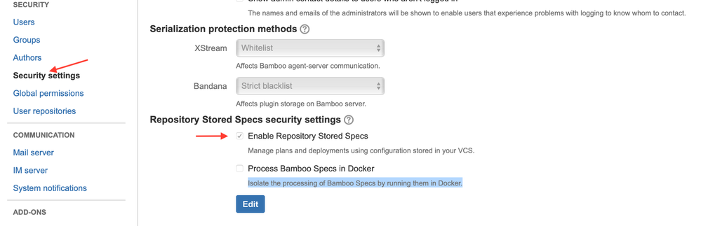

Screen Shot 2019-04-18 at 9.52.56 AM.pngThe error is fixed once the settings are right. Once a new change is pushed to specs repo, the plan gets updated. Venku

Other option is upgrading Docker to latest version on Bamboo server, which something I'll test in future.
