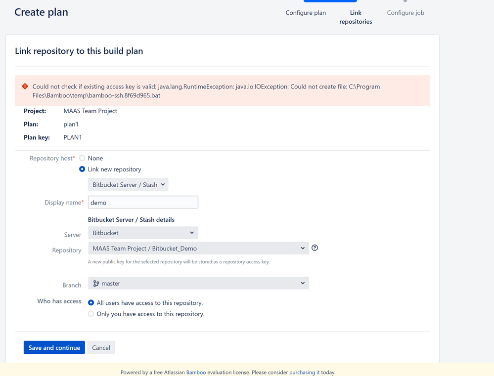

×Hi I am new to Bamboo ,trying to create a plan and link a bitbucket repository to it but i am facing the below error while saving the repository
can someone pls help on this.
error:
Could not check if existing access key is valid: java.lang.RuntimeException: java.io.IOException: Could not create file: C:\Program Files\Bamboo\temp\bamboo-ssh.8f69d965.bat
