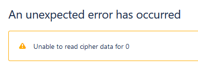

Hi, when I attempt to link to a BitBucket Server repository with Bamboo 6.9.0 I get a fatal error 'Unable to read cipher data for 0'.
This is a brand-new install of Bamboo. It has been linked with our existing instance of BitBucket Server and the link has been configured on both instances. Each link shows a green 'connected' status.
Attempting to link a repository in the Admin console under Linked Repositories results in the same error:
Bamboo version: 6.9.0 build 60909 running on CentOS 7.6.1810
BitBucket Server: v5.6.2 running on CentOS 7.4.1708
Log file extract:
