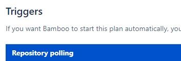

I did that as a workaround, but this is based on polling and not a trigger on commit? Or is that what happens by default? I think not because with polling you get the following 'Repository Polling' trigger (when viewing the configuration via GUI):

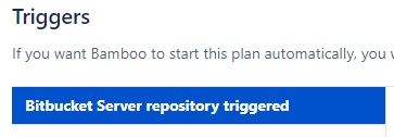

And not this `Bitbucket Server repository triggered` trigger:
Alexey Chystoprudov
January 10, 2022
Yes, missed that part when made improvements to Triggers support in YAML Specs.
Will address it shortly, please track https://jira.atlassian.com/browse/BAM-21559 for updates.
