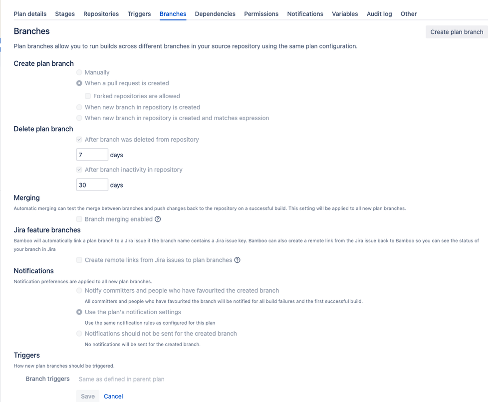

Create a plan and link it to the repository on which PR will be created and then on this plan you can enable branches as shown below, whenever a PR is created it will create a new plan branch on this plan and automatic build will start on it.
Read more about it at Using plan branches , you can use the below options from Branches tab on your plan

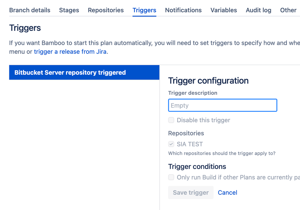

In order to stop where should i go to remove the trigger, as shown below i cannot remove trigger.

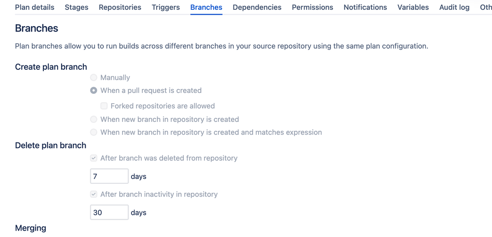

I cannot edit this. What permission should i have?

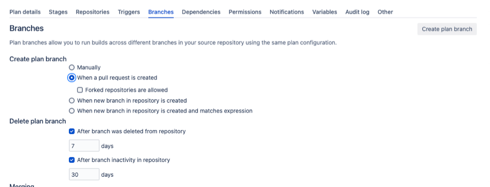

I was able to sort the issue now the plan branch looks as it needs to be. However, i deleted the PR and recreated a new PR didnt work, what am i missing?

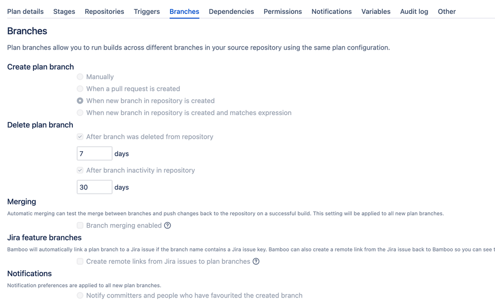

I was able to figure out what needs to be changed. Ur comment helped me a lot.
However im getting this error now but i can do what i wanted. But this error annoys a bit
