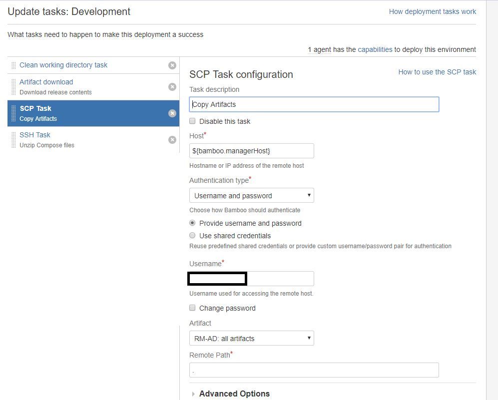

Hi @Pratik there is an example for you (all this task is on deployment proyect):

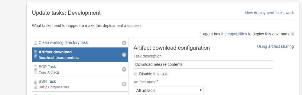

1. Download the Artifact (on agent)

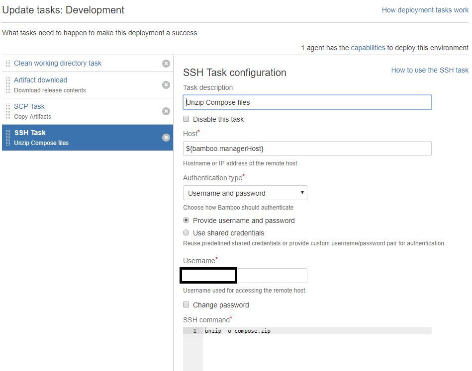

3. Unzip file on the server

1. This download is from build plan and shared artifacts builded there. If you artifact was builded out of plan you must download from source instead of default download.
