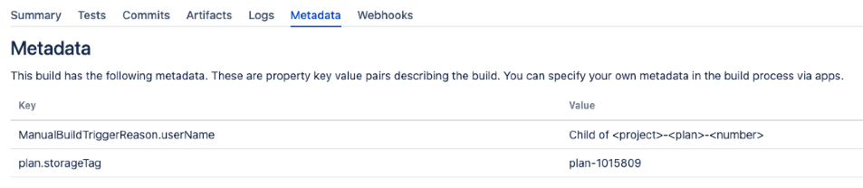

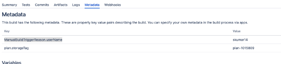

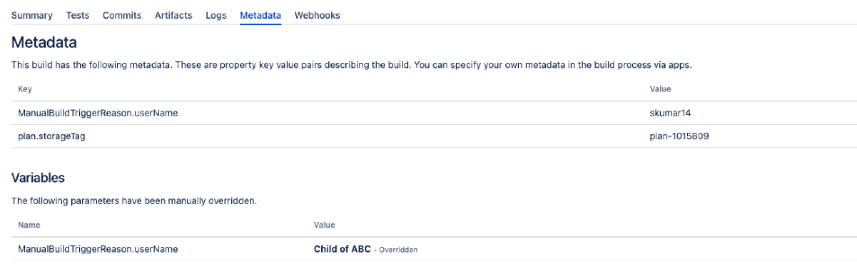

If my understanding is correct, you are looking at the Metadata screen for a buildresult and looking at the parameter ManualBuildTriggerReason.userName as per below and looking to change the values to a custom one. Please correct my understanding if it's correct.
Solution 1 :

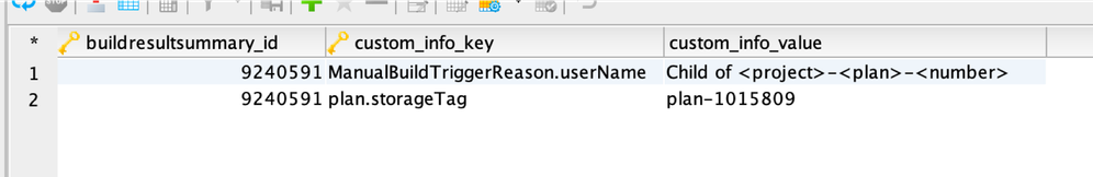

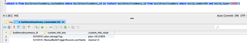

As far as I know within the REST API this param can't be changed but can be overriden(see solution 2), if some how you can modify the column custom_info_value under buildresultsummary_customdata table, you'll be able to see the modified value in Bamboo GUI.
This will require some update query to be fired to the DB.
After the update is run

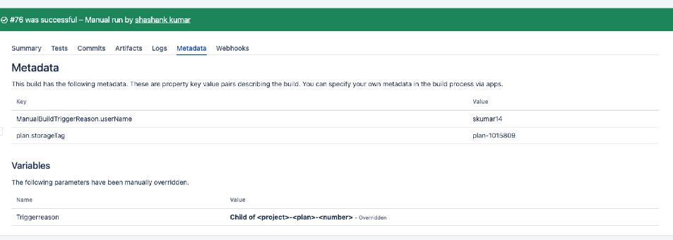

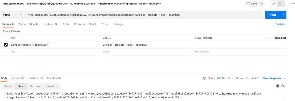

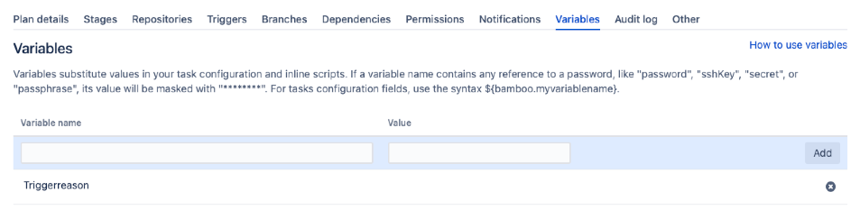

You can define a custom variable on the plan, see below
You'll be able to see this under Variables tab
You can also pass the system variables as well like bamboo.variable.ManualBuildTriggerReason.userName and it's values would be overriden

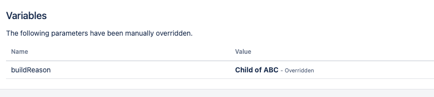

http://localhost:8085/rest/api/latest/result/SCRIP-TIC-91?expand=results.result&buildstate=successful
I see you are talking about the below buildReason
I don't think so you can modify this.
As per https://docs.atlassian.com/atlassian-bamboo/REST/8.2.5/#d2e5921 you can pass variables to the Post Request, even if you try to pass buildReason as a variable Bamboo will just consider it as a new one and add it to the metadata
