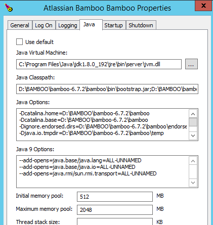

BTW .. Other than modifying my startup config as shown here :
Do you know if I add & modify the atlassian.bamboo.build.disable="true" definition to a config file to achieve the same effect?

It's looking like for a windows' service it could only be the bamboo\bin\service.bat file.
One would modify the  --JvmOptions  string as appropriate and de-install/re-install the service. Kinda belabored for just that one change...
So I guess the the "properties" interface way IS actually simpler (with a service stop/start) thrown in too ...( :-)
