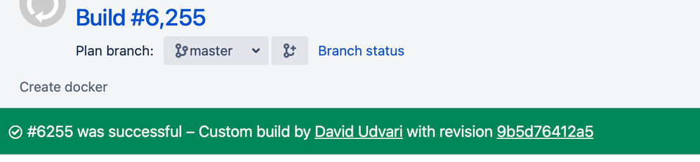

David Udvari
October 2, 2024
Hello,
Of course.
This is a screenshot from our working prod bamboo Képernyőfotó 2024-10-03 - 8.44.27.png

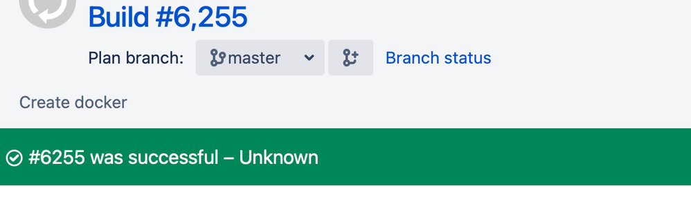

This is the new migrated bamboo:
Shashank Kumar
October 3, 2024
Hello Udvari,
This seems little off, I don't think so there is any particular file on the Bamboo server where this Info would be fetched.
Either this data is Indexed or a call is made to DB to get the data, can you try to Reindex Bamboo and see if it helps, refer Reindexing data
