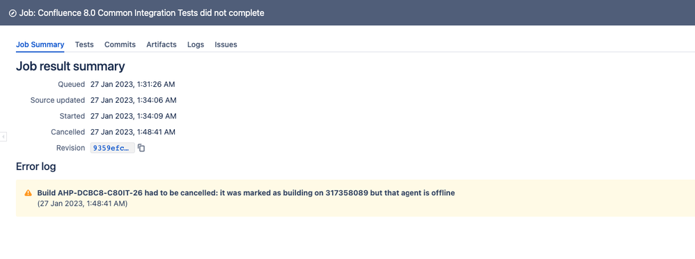

Some builds stopped after running for more than 20 minutes and the message received is (See screenshot || name: BambooAgentOffline.png):
Build AHP-DCBC8-C80IT-26 had to be cancelled: it was marked as building on 317358089 but that agent is offline

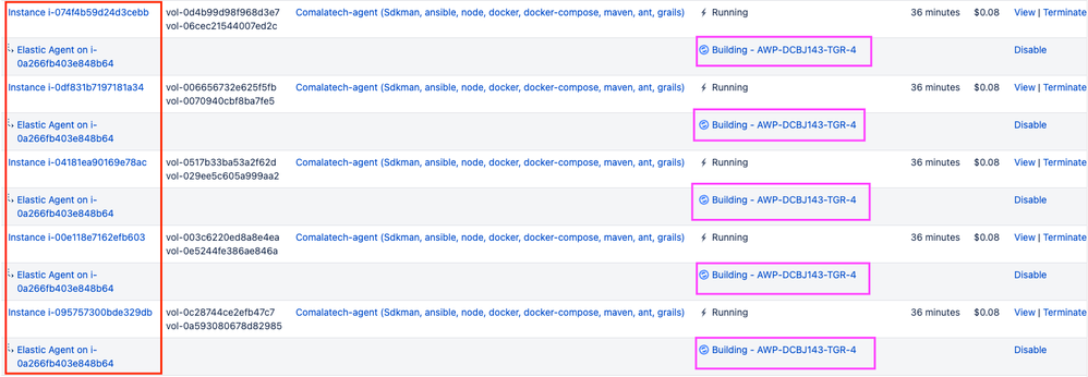

On the other hand, I can see some error information in the instances list (/admin/elastic/manageElasticInstances.action).
(See screenshot || name: Bamboo_agents_information.png)
As you can see, the information is duplicated but it's wrong. It shows that 5 builds (they have the same ProjectKey-planKey, so I understand they are the same build).
They are running in the same bamboo agentID but in different EC2 instancesID.
