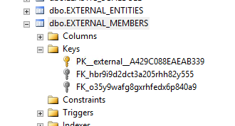

RESOLVED:
Case Sensitive.
Recreated constraints with uppercase names, deleted the lowercase names.

in the DB there is nothing in 'Constraints' the FK_... object is in 'keys'
