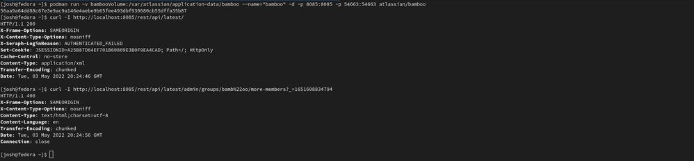

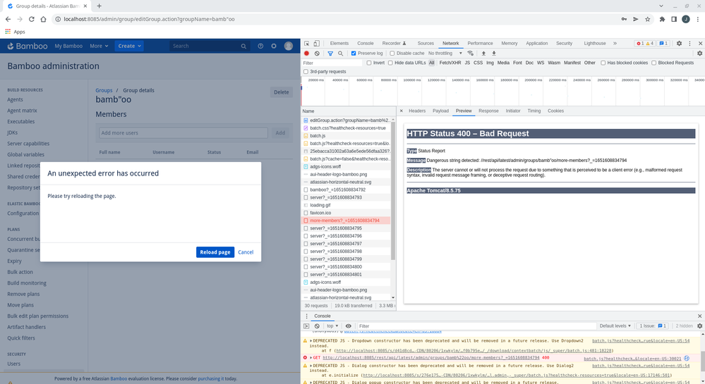

I have external Active Directory integration with groups that contain quotes in their name (example: che"ck), and since our last upgrade from version 6.10.2 to 8.0.0 we are having trouble to edit plan permission or view group details/members because those requests use the /rest/api/latest/admin/groups/{name : (.+)?}/more-members?filter endpoint that return http error code 400 - bad request.
i tried different tomcat versions (from tomcat 8.5.X to 9.0.X) with no success
i also tried empty tomcat application locally and checked http://localhost:8085/che"ck endpoint that returned http error 404 not found, so i dont think its tomcat issue
i also tried the confluence API (7.13.0) with the same groups with no problem at all.

i tried to reproduce the problem with the latest bamboo version with bamboo official docker image but the result are the same.
Joshua

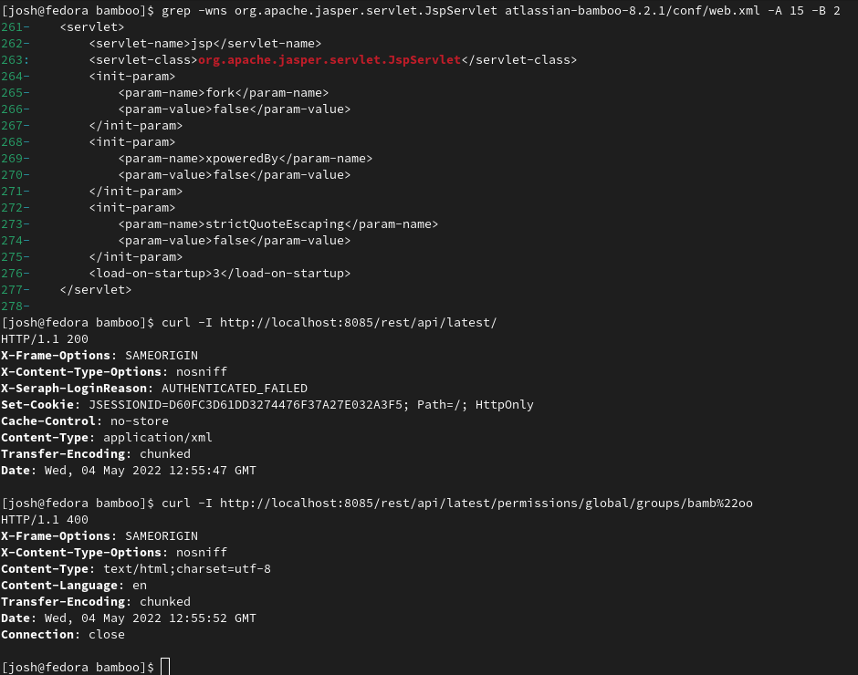

This sounds like a good use for the STRICT_QUOTE_ESCAPING property.
That setting was deprecated on Tomcat 8. Instead, you need to add something like this to your <bamboo-install>/conf/web.xml under servlet class org.apache.jasper.servlet.JspServlet:
<init-param>
<param-name>strictQuoteEscaping</param-name>
<param-value>false</param-value>
</init-param>
Regards,
Eduardo Alvarenga
Atlassian Support APAC
Joshua Greenman
May 4, 2022
Hello @Eduardo Alvarenga
Thank you for answer me unfortunately it didn't help
Eduardo Alvarenga
May 4, 2022
Hello @Joshua Greenman
Apologies for the unworking configuration. The following characters are considered "XSS_RELATED_CHARACTERS" and are banned from being used by requests.
I cannot explain at this stage how that worked on older versions of Bamboo. The source code relates to that protection since 2015. Maybe a JDK x Tomcat combination in an older release that got badly implemented.
Please refrain from using such characters on groups and usernames.
