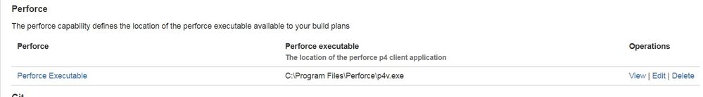

I have added bamboo Server Capabilities for perforce.

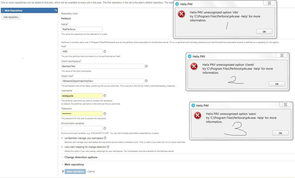

On providing perforce detail while adding repository, getting following three alerts from p4v client-
Screenshot_3.jpgUser id and password are correct also url with port is correct. I am able to get data from repository with this detail.

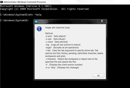

p4v.exe is already there in my PATH and also I run p4v -help on command prompt, getting following result. I dont see any option named 'info'.

P4V is a visual client. Bamboo need command line client
https://www.perforce.com/downloads/helix-command-line-client-p4
Bamboo Server capabilities have to be updated with this p4 command line client too.

I have changed server capabilities to p4.exe. Now I dont see any error popup. But getting following message for Depot view-

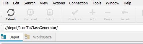

My depot view looks like
I tried many combinations-
//depot/JsonToClassGenerator/
//QS-0049/JsonToClassGenerator/
//QS-0049/depot/JsonToClassGenerator/

From the screen shot of the task, if the Client (workspace) "BambooTest" is used, the Depot view need to be in the format "//BambooTest/JsonToClassGenerator/..."
anupdg
June 22, 2018
Ahh...
I have tried that to. Got the issue now. I was missing trailing three dots. Can it be specified on the documentation that trailing three dots are mendatory(/...). Its not that clear in the documentation.
