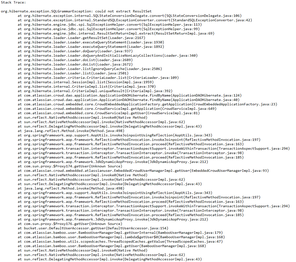

I have found and setup the bamboo.cfg.xml that I believe to be the correct one. I now get an error. I have tried posting the error a few times but the post always disappears.
Edit: Looks like my other posts have reappeared.

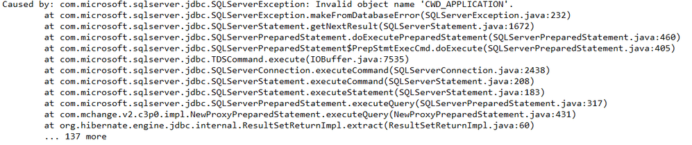

Chris
May 15, 2020
Here are two images of the stacktrace.Bamboo Error P1.PNGBamboo Error P2.PNG

Hi @Chris ,
The error seems to be related to Crowd, although i'm not finding much information on the error. It's possible data got corrupted. Since you have a backup, I'd recommend reinstalling the previous version to a separate database, importing the data and running the upgrade again. It should be a smooth process since you're on a newer version of Bamboo.
So after restoration, download the new version, migrate over custom configurations to the new installation (memory e.t.c), set home directory to current home directory, stop the current service, update the service so it points to the new installation and start up the service.
