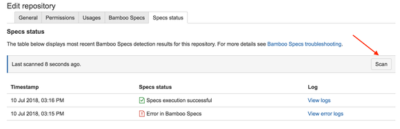

On Bamboo 6.5.1 we added an option in Repository Configuration>>Specs Status to manually scan the repository for specs code without using a webhook:

While the improvement request mentioned by my colleague @Alexey Chystoprudov(BAM-19837) is not implemented, you can be creative and develop an external script calling the same endpoint used by the "Scan" button.
for example:
curl -u <USER>:<PASSWORD> -H 'content-type: application/json' -H 'accept:application/json' -X POST http://<bambooURL>/rest/api/latest/repository/<repositoryID>/scanNow
ps. You can find the <repositoryID> hovering the mouse over the linked repository name.
But first, of course, you'll need to upgrade Bamboo to 6.5.1 to have this endpoint available.
Please let me know what do you think about this workaround.

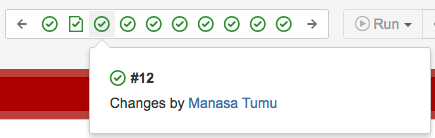

So i'm finding a difference in code detection for a JAVA Spec and YAML.
"https://company.com/rest/api/latest/repository/scan?repositoryId=" endpoint is helping in triggering the spec updates for java and YAML but after the plan is created for any new code commits,
Plan created by YAML
- Triggers a build for all new commits without any webhooks.
Plan created by Java Spec
- Doesn't trigger any build.
Hope its clear, let me know. Thanks!

Now I think I got it!
This is probably happening because when you use YAML, even though you are not specifying any repository or/and any build trigger in the configuration file, Bamboo will assign the repository you're using to store the specs file as default and will automatically define a repository polling trigger type to it.
If you want to add a trigger to the plan generated by your java RSS specs code, you'll need to specify it in the code, please see the example below:
