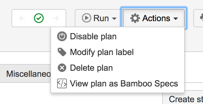

Alexey Chystoprudov
September 11, 2017
try to go other way around. create plan with CVS repository and then go to Plan configuration and choose "View plan as Bamboo Spec"Screen Shot 2017-09-11 at 21.24.13.png
