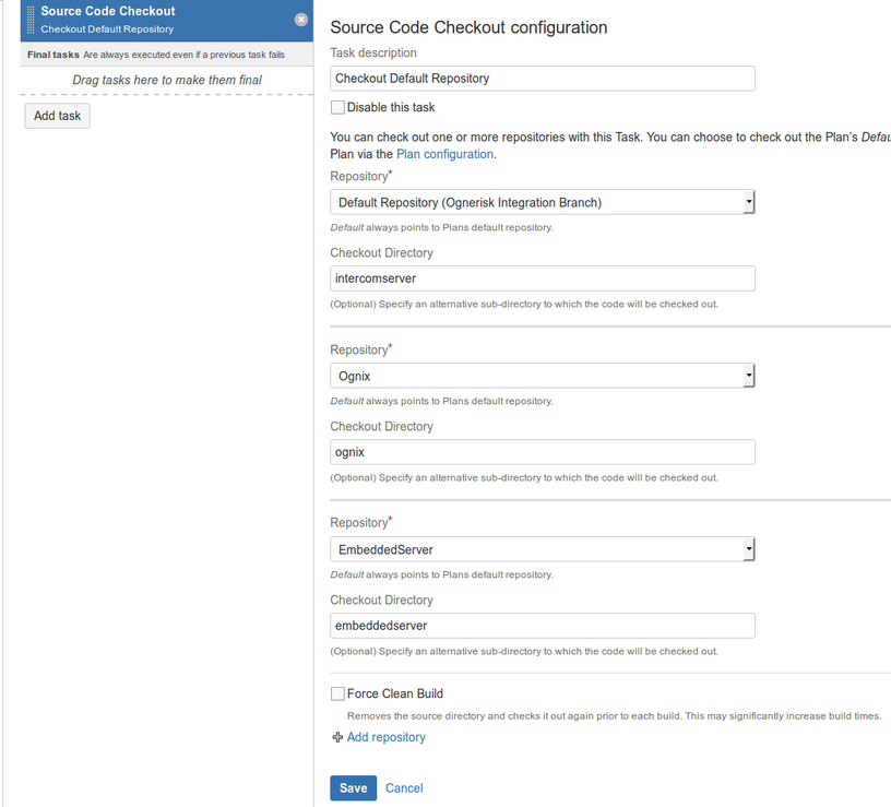

Here's the complete task config
After running the job only the source files of repo 3 (embeddedserver) exist in the working directory. The sub directories have been created but are empty.
rsperafico
January 9, 2018
Hello @Gerald Ortner,
Thank you for your update.
Could you please make use of 3 Source Code Checkout tasks as suggested previously?
Kind regards,
Rafael
