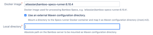

Hi @[deleted] ,
If you are running Bamboo v6.9 or above, you have under Bamboo administration >> Security >> Security Settings >> Security and permission >> Repository Stored Specs security settings >> Process Bamboo Specs in Docker the option of:
  • defining your own Docker Image for Repository Stored Specs (RSS).
  • (Location directory) Use an external Maven configuration directory
