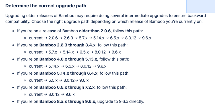

You'll need to follow the upgrade guide path to move from very old version to the latest, I don't know current version so can't tell you the path, but you can refer Bamboo upgrade guide for the complete details.
Please check the upgrade path as below
You'll also need to Validate the version of DB and Java if they are supported on the version you are trying to move to, please check Bamboo Supported platforms to know more about this.
