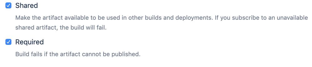

Hi Alexey,
Thank you for your answer, but I already did that before. Any other ideas?

Alexey Chystoprudov
September 14, 2019
Your instance might be affected by https://jira.atlassian.com/browse/BAM-20301 which is solved at Bamboo 6.9.0
