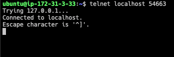

sators
March 5, 2019
No, nothing is returned after the initial connection.  Screenshot below.  For clarity sake, this command is being run directly on the server running Bamboo.  No characters are being typed other than the initial command.
Trying to manually type `?ActiveMQ` after connected also yields no results/response.

Foong
March 5, 2019
Could it be antivirus blocking the output?
