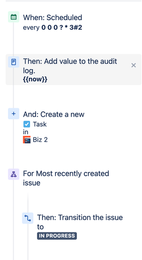

As to your other error, I'm guessing it might be because you are not using a "Branch" for your transition action, and so Automation doesn't know what issue to transition.
What you need to add after the Create issue step is:
  • New Branch
  • Branch rule / related issues
  • Most recently created issue
And then within this branch, you would put your Transition action.
It should look something like this:

OK, I see.  So it appears we can't 'create issue' then 'transition issue' within the same rule without something inbetween to help it along.
Good answer, I'll give that a go and let you know how I get on - thanks!

Hey @Darren - you got it. The 'transition issue' rule needs to know what issue you want to act upon.
So with a scheduled trigger (which doesn't specify an issue, unlike other triggers), if you don't put it within the branch like I specified, it doesn't know which issue you want to transition.
