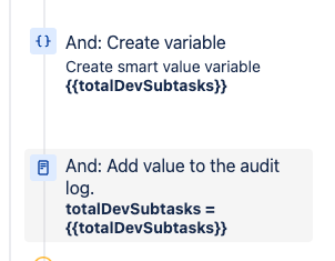

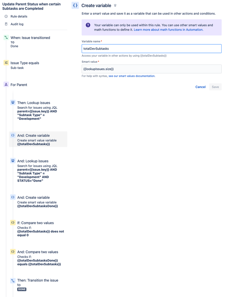

Darryl Lee
December 12, 2022
Hey @Jan de Beijer OK, thanks for sharing more of your rule. I see the problem!
The variables {{totalDevsubtasks}} and {{totalDevsubtasksDone}} must have the value of:
{{lookupIssues.size}}
This is the key. That is a Smart Value returned by the Lookup Issues component.
They should look like this:

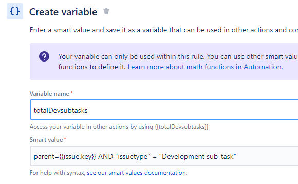

Jan de Beijer
December 11, 2022

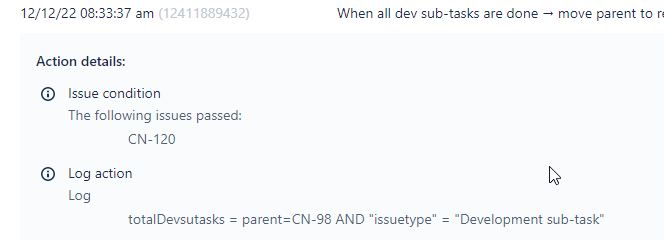

Hello and sorry Darryl to bother you again with my issue (thanks again for your repley).
I think i do something wrong with my counts, because i did the following in the log.
and in the log audit it say's (no counts)
so the log don't tell me a count.
In the "lookup issues i have
my compleet rule looks now like this:

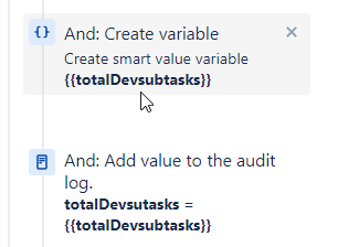

Hey yeah, hopefully we are getting closer! So the Log action doesn't actually do JQL queries or anything. It can basically only "print" stuff, like whatever variables you already have.
SO to get the counts, you could just insert Log action after each Create variable component like this:

so first i put the "log action" into the rule with "Issuetype = {{issue.issuetype}} the respons was a issue type number, so now i think i understand the meaning of "log action" but i realy don't now what i have to put into the "log action" so that he will give me back the counts he did.
i just put in the rule, but that is not working, can you give me 1 example of my rule.
for example what should i put in the action log, so the result is the counts of the number of issue types (development subtask) with status "done" so i have something to play with.
thanks

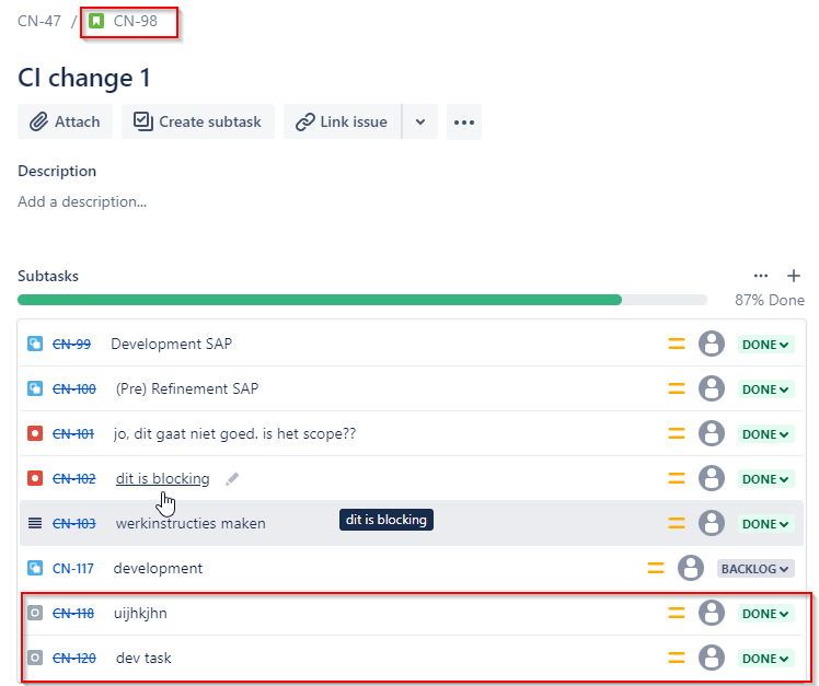

Jan de Beijer
December 9, 2022
hello Darryl, i'm just a newbe in Jira,
Sorry, but i don't understand your comment:
I would start inserting this maybe at the beginning of the rule, and just have it output:
I also used this to get the values of the variables I set, just to make sure everything was working as expected, and for instance to see the # of Done vs Not Done sub-tasks.
where and how should i put that in my rule??
i didn't change anything and start the rule again, so now i have only 1 rule loged instead of the log for all subtasks.
where is CN-98 is my parent
and CN-118 and CN-120 are my development subtasks.
image.pngso i wil put the suggestion of you as mentioned
into my rule, but i don't now what you mean and where is  should put in in which way.

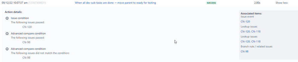

Hrm, I just tested again and it doesn't matter if the trigger specifies transition to Done or not (although you should probably do this to reduce the # of times the rule runs, as that can be limited, depending on your tier).
I can see my issuetypes are different depending on which sub-tasks I transition. The question is whether your tests show the same thing.
Darryl Lee
December 8, 2022
Hi - I got this to work for me with issuetype. I made my rule look just like yours.
So are you saying that CN-118 is NOT a Development sub-task? That's odd. The first IF statement should have not matched and you should be seeing "No actions performed", not "Success".
OH! One difference I noticed is that your trigger is not specifying Transitioned to Done! Maybe that is the problem!

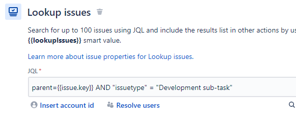

Thank you very much for your quick and clear answer. I'm sorry, but a already created a new issue type (sub) named "Development sub-task" and i tried to change your field flow to the issuetype flow like this:
on number 3 i have the following JQL:
parent={{issue.key}} AND "issuetype" = "Development sub-task"
and on number 5 i have:
parent={{issue.key}} AND "issuetype" = "Development sub-task" AND STATUS="Done"
I published the rule, and tested it. in the "audit log" he executes the rule for every subtask thas is related to the story (for the regular "subtask" and for the "Development sub-task" and on every execution the log says:

Darryl Lee
December 8, 2022
AH, ok, thanks for the clarification.

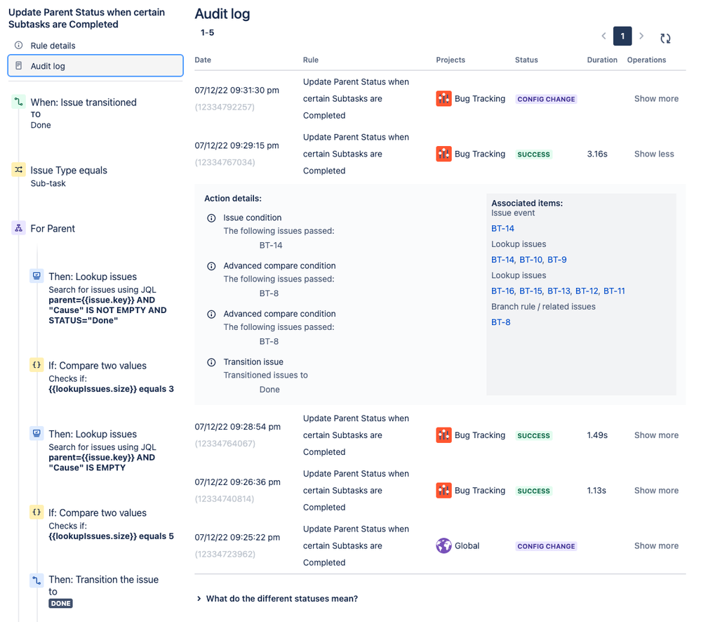

So the key is that ALL of the subtasks of a certain type (let's stick with a Custom Field I've named "Subtask Type") have to be done. Got it.
I think this should work:
The trick is that I'm doing two Lookups:
parent={{issue.key}} AND "Subtask Type" = "Development"
That's all of Development subtasks that need to be done. I then store the # of issues that matched, {{lookupIssues.size}}, to a variable: totalDevSubtasks
And then I check for how many Development subtasks are actually done:
parent={{issue.key}} AND "Subtask Type" = "Development" AND STATUS="Done"
And that # gets stored in totalDevSubtasksDone.
Then I do two checks:
1. Is totalDevSubtasks not equal to 0?
AND
2. Is totalDevSubtasksDone equal to totalDevSubtasks
If so, then move the Parent to Done!
Please let me know if this is closer to what you needed.
