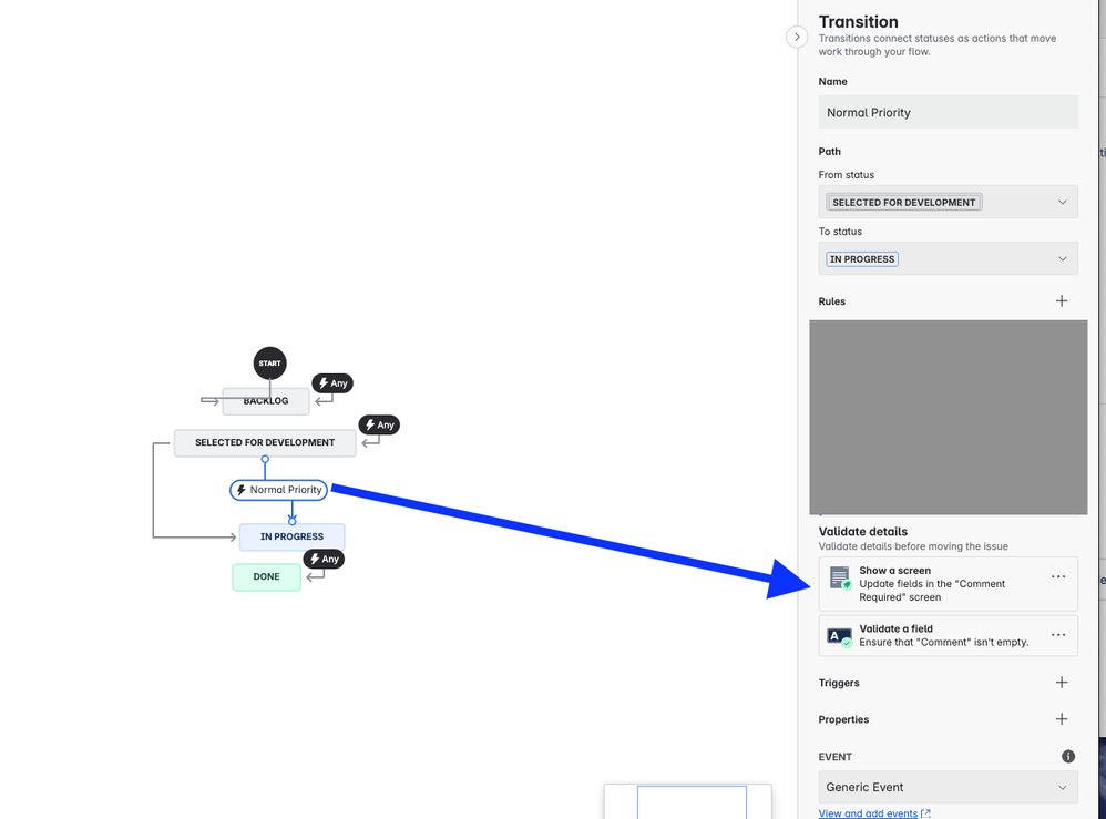

Did you add a Transition Screen to that same transition? Can you show us a screen image of the transition? Here's an example of what I'm looking for:
If you did add a transition screen, can you show us an image of that screen being shown when you make the transition?

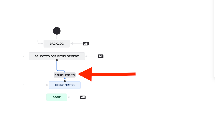

Lastly, can you show us the workflow diagram pointing out the transition you have changed? This is an example of what I'm looking for:

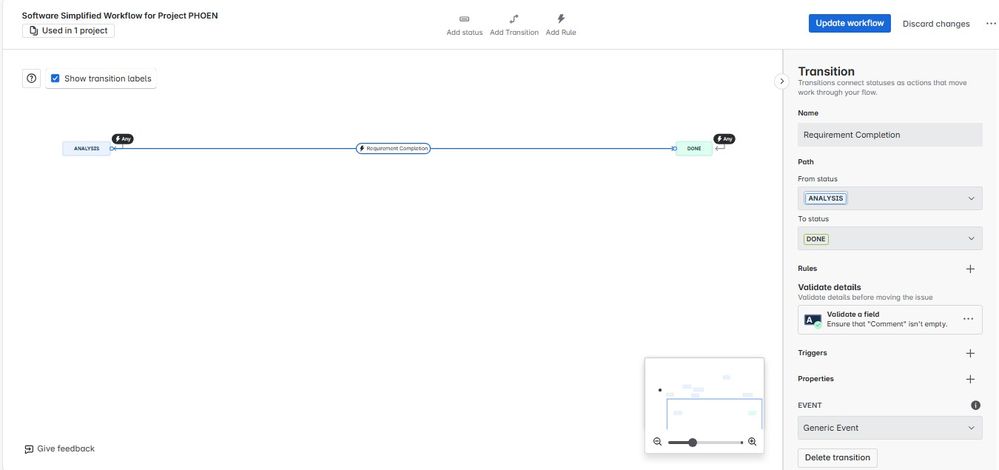

I have attached the screenshot of the workflow. Requirement completion is the Transition. When the requirement gets completed and if the developer moves it to done status, if the comments are empty it should prompt the developer to update the latest information. After providing the comments it should allow the workitem to move to done state.

Thank you for that image, but it does not match the example I showed. In my example I am using the original/old Workflow Editor. It appears that you are using the new workflow editor.

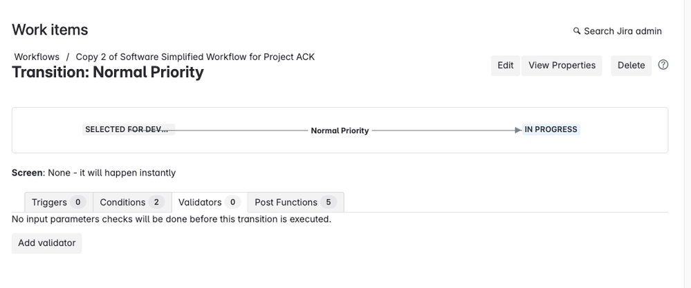

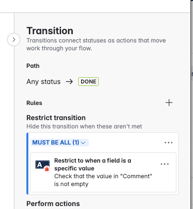

Specifically I would like to see the Validator information. In the new Workflow Editor you may see this in a panel on the right under the heading Rules.

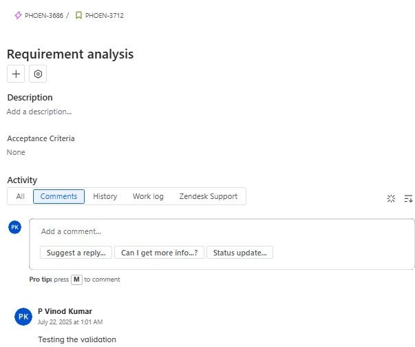

Can you also provide us with images of the screens you see when you are executing the transition within an issue? I would like to see that you are getting prompted to add a comment, and that even when the Comment is filled in you get a message and are blocked from proceeding to complete the transition.
Thank you for those images. That is helpful.

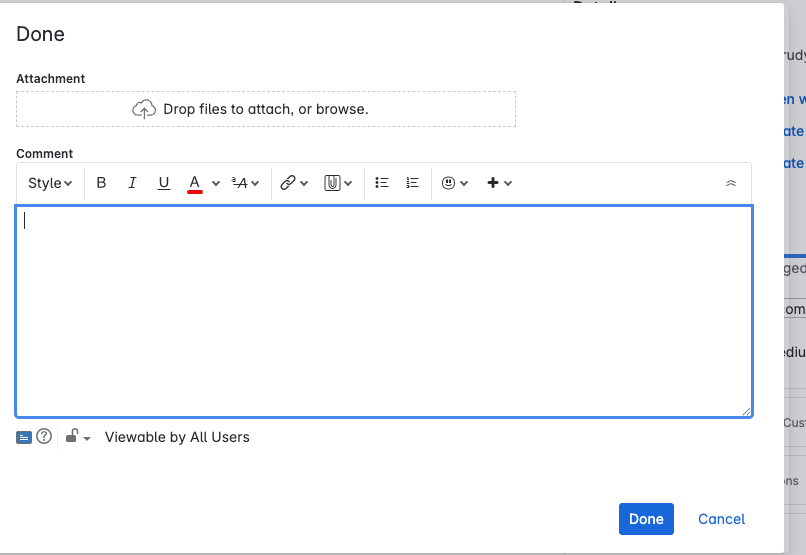

The solution I described aligns with #1, but you did not implement it completely yet. For solution 1 you would need to also create a screen that can be shown during the transition so that the user can enter a comment during the transition, allowing the validator to check if a comment has been entered during the transition.
When the transition is attempted a pop up screen similar to this would appear, and the transition would not be allowed to complete until the user entered something in the Comment field.

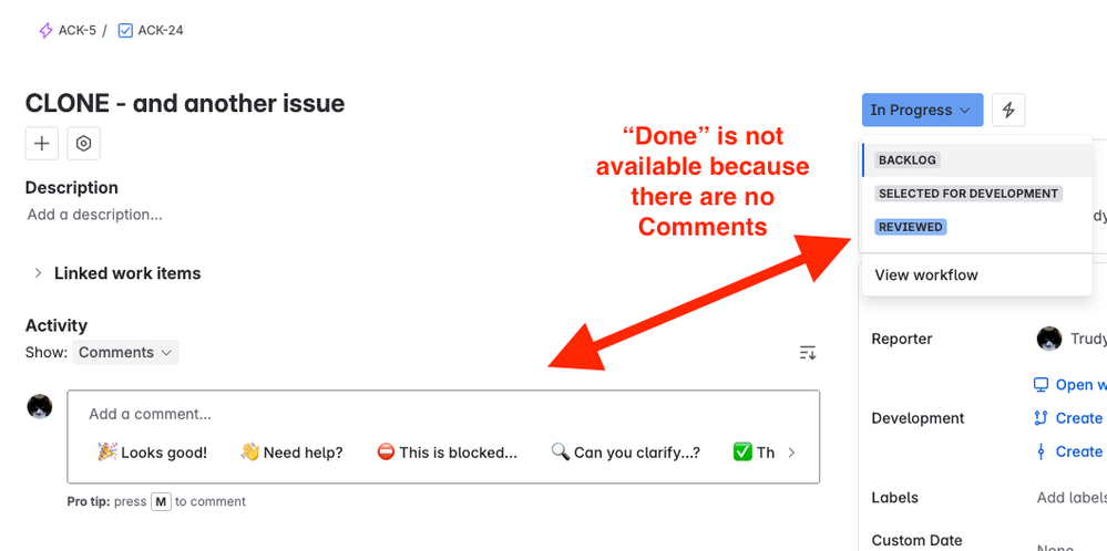

There is not a native Validator available that check for Comments pre-existing in the issue, excluding any comment that is entered during the transition.
Options would be:
1. In the transition use a Condition instead, specifically the Value Field Condition to check that Comment is != to <empty Value field> when compared as String. That will prevent the transition from even being available if there are no pre-existing Comments on the issue.
