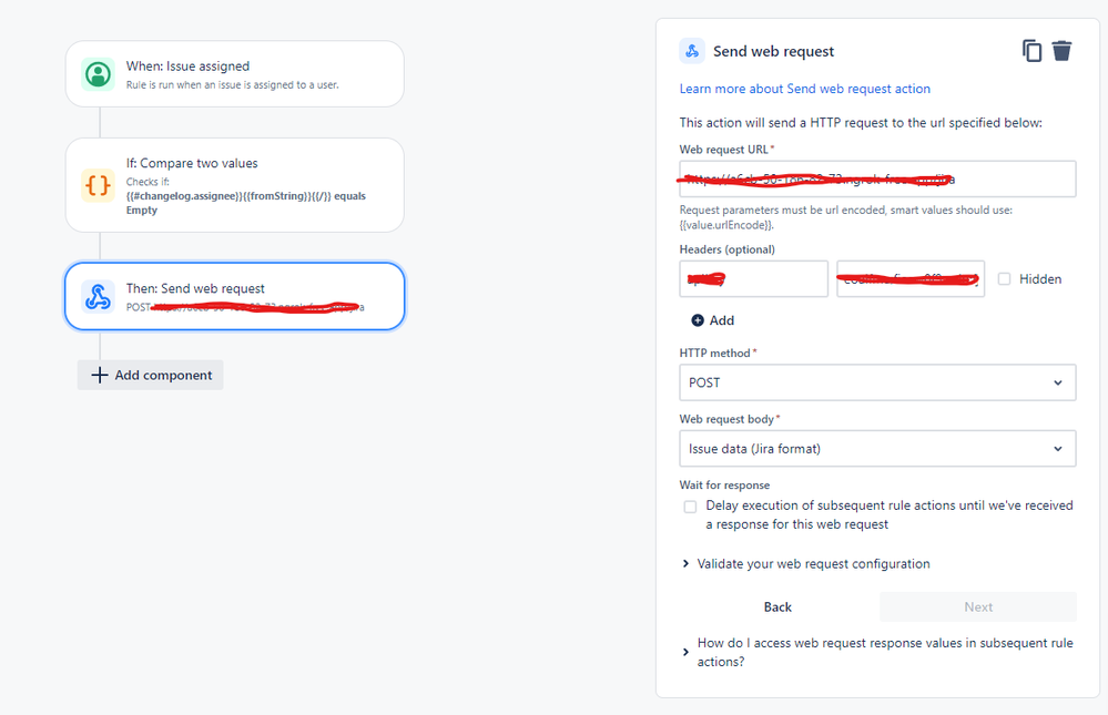

Rather than trigger an automation when a ticket is created, we are doing it when a tickets is assigned for the first time only. But the automation needs to contain identifying information about the account that created the ticket.

Few things I can suggest:
  • Try using the "Validate your web request" Option to see if the API works first
  • I'm assuming you're sending data to another system, does this system accept Jira's issue data format?

One option I was pursuing:
If you set up an animation on ticket creation, the user fields include the account information of the creator. I could do a rule to send the user.emailAddress to a custom field or comment to save it and query it later??
I haven't figured out the syntax for that.
