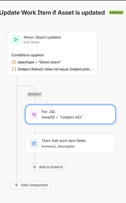

I am sorry, I should provide a bit more context so you know what help is required :)
I am building a simple automation just to update a work item when an asset is updated.
As you can see, it is very simple, and I just filter out the work items by comparing a value in the work item with the object id of the object that is being updated.
I can use an attribute in assets or a number field in the work item, for example, but both can be tampered with and that would break this connection.
So to be sure that the value I sue for comparing can't be altered, I wanted to use the object id since that can't be changed in the UI and a read only field for the same reason.
But, I can't use that because a read only field does not allow a = operator...

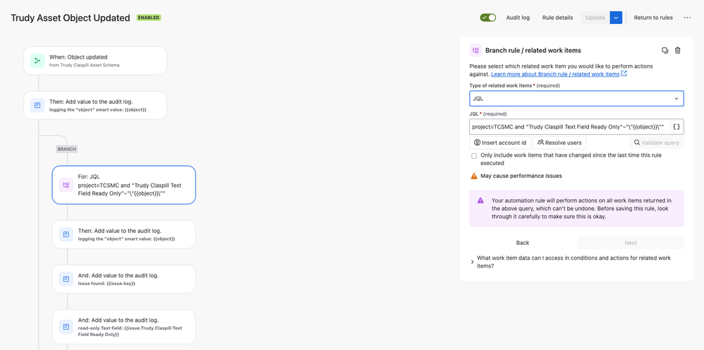

Hello @__ Jimi Wikman
I did some testing of text searching against a custom field of type "Text Field (read only)"
In a JQL statement you can look for an exact match with the CONTAINS operator for a text field thus:
Field ~ "\"value\""
I created a "Text Field (read-only)" type field and set it to "TCAS-5331"
I executed a JQL statement of
Field ~ "\"TCAS-533\""
No issues were returned. The value I provided was not recognized as "contained" in the actual value of TCAS-5331.
I then executed a JQL statement of
Field ~ "\"TCAS-5331\""
The matching issue was returned.
I applied this to an Automation Rule triggered by Object Updated, with a Branch on JQL and it worked to retrieve the issues where the read-only text field was an exact match for the object key:
Like Marc -Devoteam- likes this
__ Jimi Wikman
September 14, 2025
Good tip. I'll try that and if it excludes every other permutation and only use the exact value, which means it is the same as = in function, then that will solve this.
