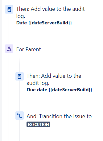

I created an if else-if branch to manage these three conditions, and in each I set a variable to hold the date.
Right after the variable is set, I have a For Parent branch to create sub-tasks and assign due dates...but they are turning up blank.

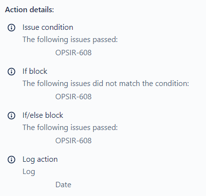

So I added a test audit log entry to see if the variable existed even just after the if else-if branch ended and it doesn't.  It's already null.
I can see in the rule audit log that the condition passes successfully so why is my variable null?

Is the log action within the if/else block or outside? The screenshots indicate that it is outside of the if/else block and that would explain why the variable is null. A smart value that is created with a if/else block is only available within that block and cannot be accessed outside of it.

It depends on where you create the variable. If you look in the article they are creating the variable first before using it in the branch. If the variable is created with the branch, you will not be able to access it outside of that branch, that's the difference.
