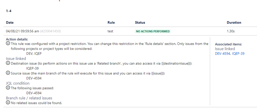

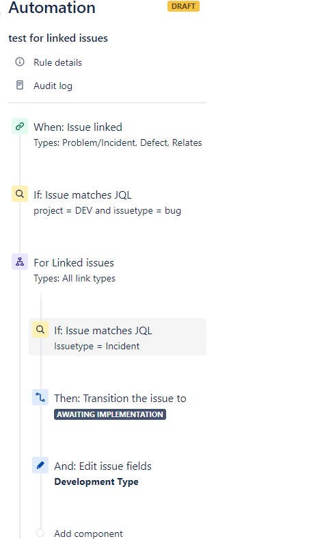

I have updated the field scope so now the scope is "multi project". Rule doesn't work but at least it gives me an audit now.
It looks like my conditions are incorrect. Any help would be much appreciated.
In theory, what I am trying to do is that.
If I create a linked ticket from a support ticket in project IQEP, it will check to see if the new ticket is created in project Dev and if the issue type is Bug, if so update  the support ticket etc

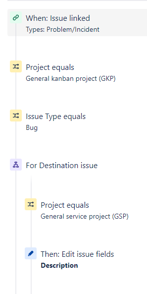

Hi @Michael Cheng ,
I would probably change the logic, because you want to do some actions in service project:
(GKP -> Dev project, GSP -> IQEP project)
Michael Cheng
August 4, 2021
Hi Hana
That has worked! Thank you very much for your assistance.
