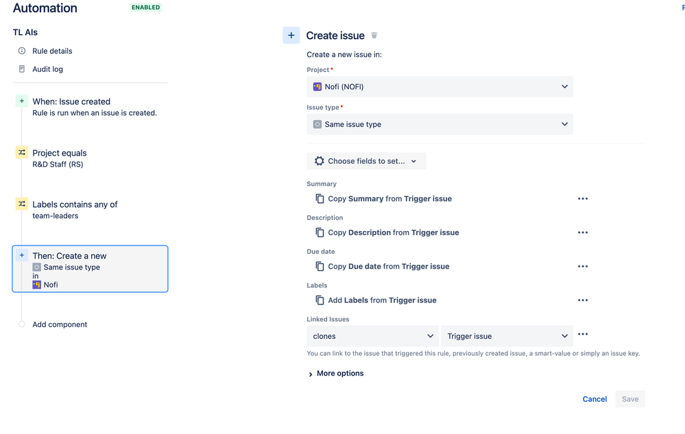

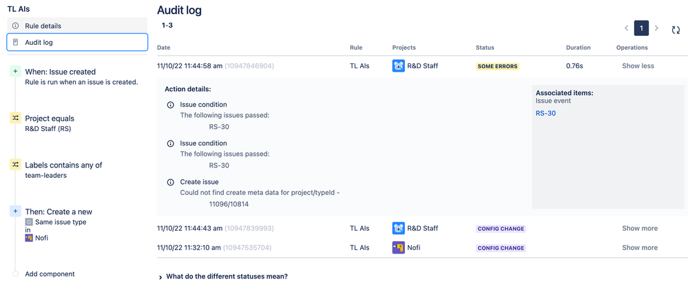

Hey,
I set up a rule that created a task in a Personal project (my, i'm the admin there). But it shows a weird error I can't understand.
Screen Shot 2022-10-11 at 12.08.27.pngScreen Shot 2022-10-11 at 12.08.36.png

Nofar Ben Kereth
October 11, 2022
Found the solution - when I specified the issue type instead of choosing "Same as" it worked
Nofar Ben Kereth
October 11, 2022
It seems the problem is in the source project as the IDs in the error belongs to it. Any suggestions?

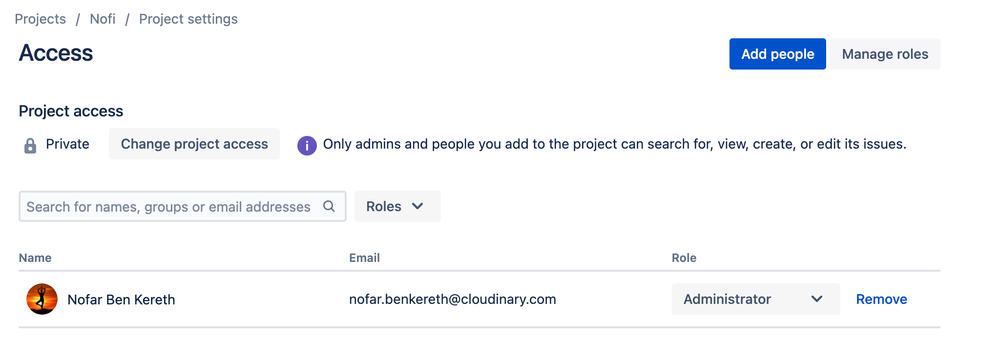

Nofar Ben Kereth
October 11, 2022
Since its a Personal Tasks project, it doesn't have a scheme. Adding the Access settings Screen Shot 2022-10-11 at 12.24.59.png
Deleted user
October 11, 2022
@Nofar Ben Kereth
Switch the automation actor to you to see if this resolves the issue.
Dan
Nofar Ben Kereth
October 11, 2022
Just switched to myself and same error shows..
