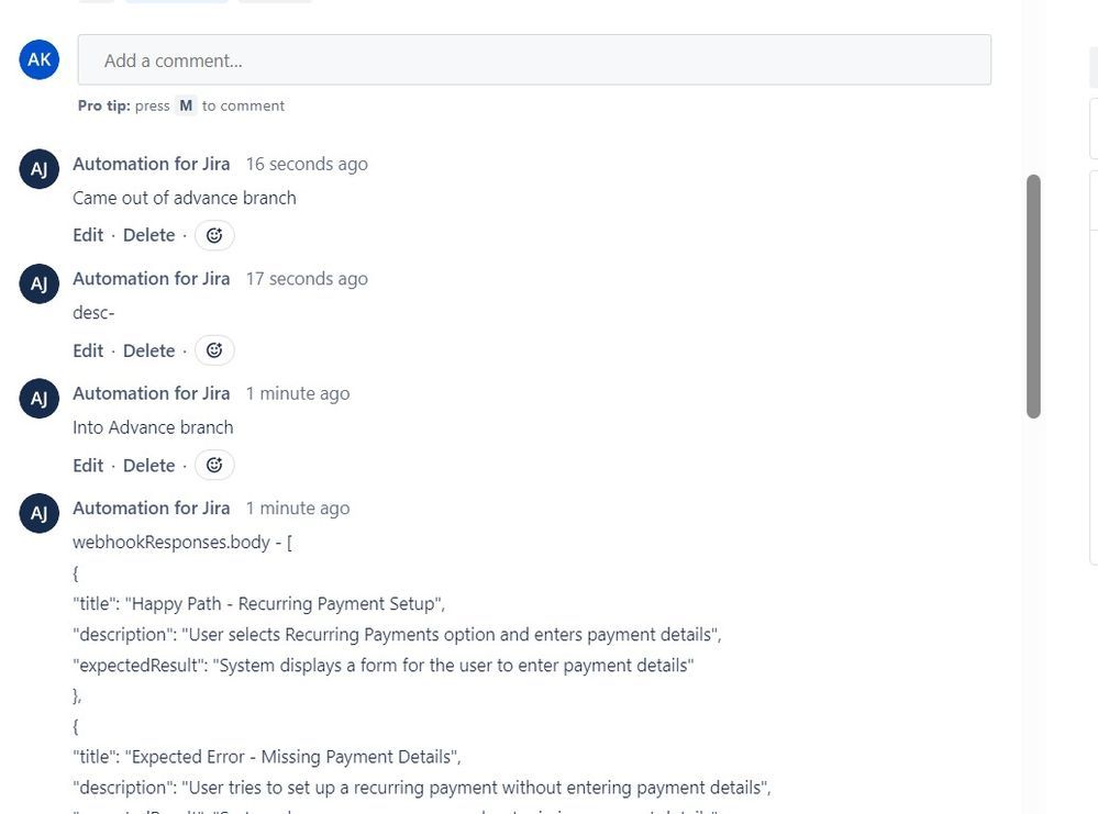

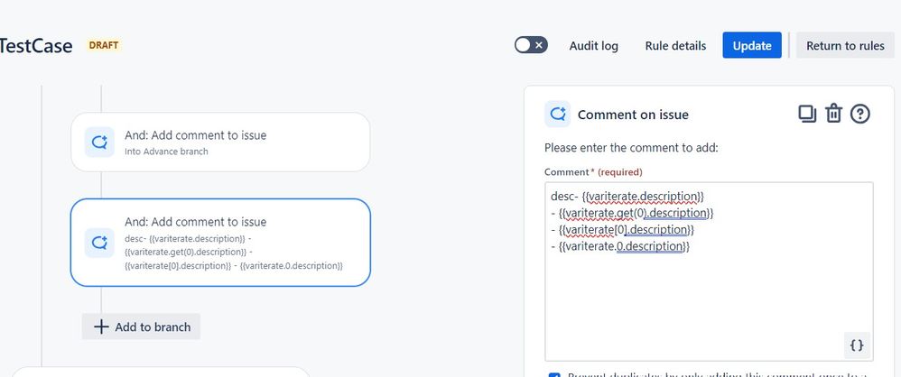

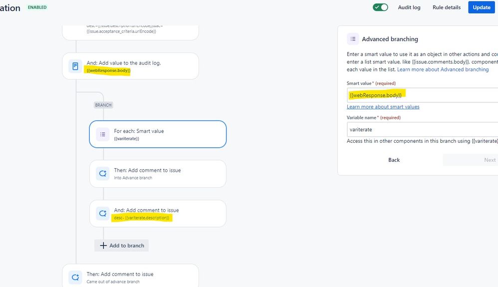

I have a web service that will return data in the form of JSON depicted beow.

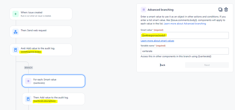

I have created a new JIRA Automation Rule that uses "Send Web Request" on Issue transition from "To Do" to "In Progress".
When I use "variterate" to get "WebhookResponses.last.body" I indeed receive data but the problem is the rule doesn't reiterate. I expect to iterate under "For Each" steps in Advance Branching, but instead, it just goes inside once that's it and comes out, though I have 4 test objects in JSON. I am seeking help to fix this issue.
(Figure 1)
The below steps "desc- {{variterate.description}}
- {{variterate.get(0).description}}
- {{variterate[0].description}}
- {{variterate.0.description}} "
Doesnt print anything after multiple tries.

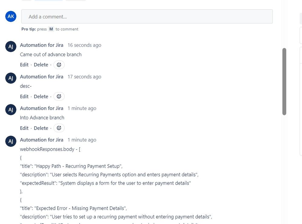

(Figure 2)

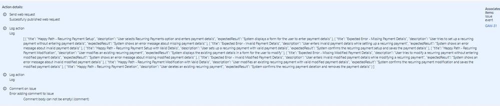

Web Service Response :
"title": "Happy Path - Recurring Payment Setup",
"description": "User sets up a recurring payment with valid details",
"expectedResult": "System saves the payment details and sets up the recurring payment successfully"
"title": "Expected Error - Missing Payment Details",
"description": "User tries to set up a recurring payment without entering all the required payment details",
"expectedResult": "System shows an error message about missing payment details"
"title": "Expected Error - Invalid Payment Details",
"description": "User enters invalid payment details while setting up a recurring payment",
"expectedResult": "System shows an error message about invalid payment details"
"title": "Test Edge Cases - Maximum Recurring Payments",
"description": "User tries to set up more than the maximum allowed recurring payments",
"expectedResult": "System rejects the request and shows an error message"
"title": "Test Edge Cases - Minimum Recurring Payments",
"description": "User tries to set up the minimum allowed recurring payments",

My immediate suggestion without knowing above point is, your advanced branch should be  {{WebhookResponses.body}} ..
Also, for rules like these, dont directly create/update issues.
First log data every where, including the branch so you can confirm you have the data at hand before updating issues.
Finally  just FYI, once inside a branch, you reference fields with dot notation... so  {{variterate.description}} to pull out the description.

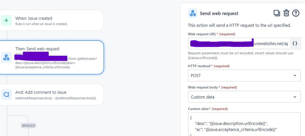

What are you calling in your "send web request"?
And right after you have made the send web request call, can you log {{webResponse.body}} and post the JSON here.
Amish Khatri
February 16, 2024

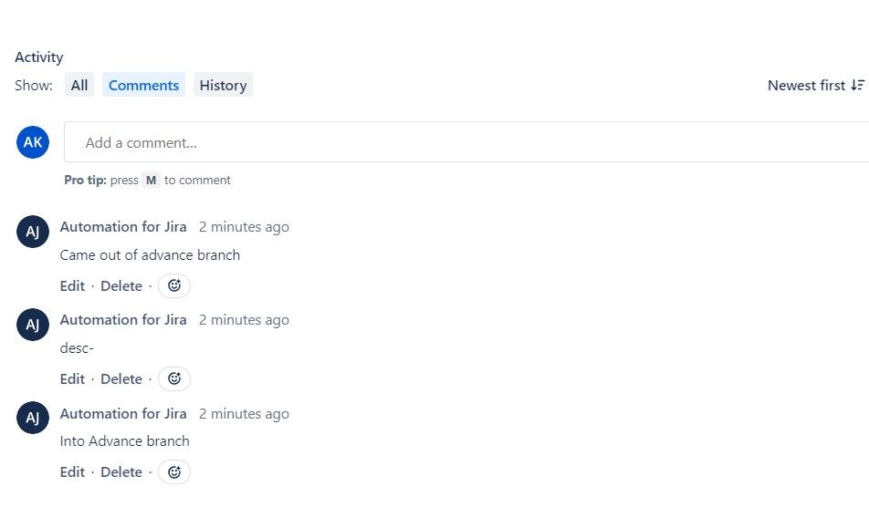

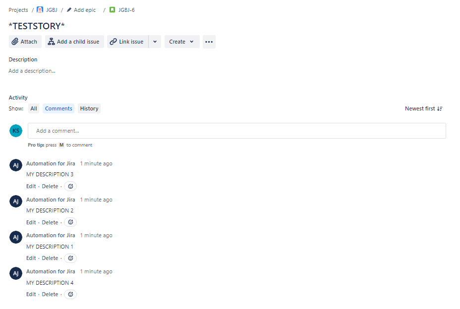

@Kalyan Sattaluri these are screenshots which generated comments on story where you can see "variterate.description" hasn't generated anything. Another screenshot is about response from webhookresponses.body
Amish Khatri
February 16, 2024
Hello @Kalyan Sattaluri below is the steps to call "send web request" and indeed receive the above JSON output.

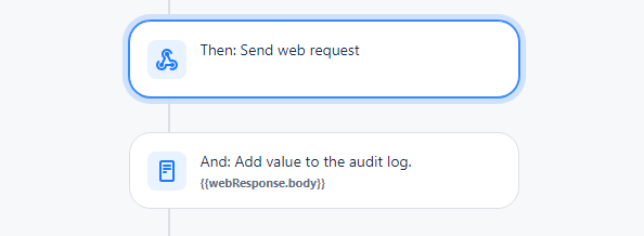

Instead of webhookresponses.body try webresponse.body.
So can you...  right after "send web request", log {{webresponse.body}}  like I have it below and share the JSON.
Kalyan Sattaluri
February 16, 2024
@Amish Khatri

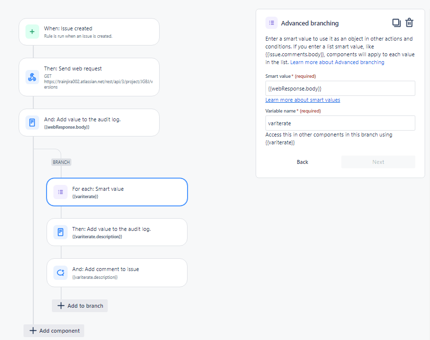

Make your rule like I have below and share complete audit log. Please pay attention to highlighted steps and dont bother updating comments yet.

Below are comment logs received from the automation rule @Kalyan Sattaluri . You can see " desc - " which means, it doesnt print variterate.description however it has printed Webhookresponses.body as "WebhookResponses.body"

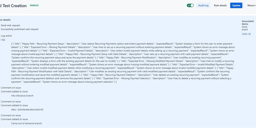

ameesh khatri
February 19, 2024

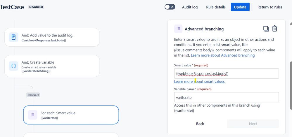

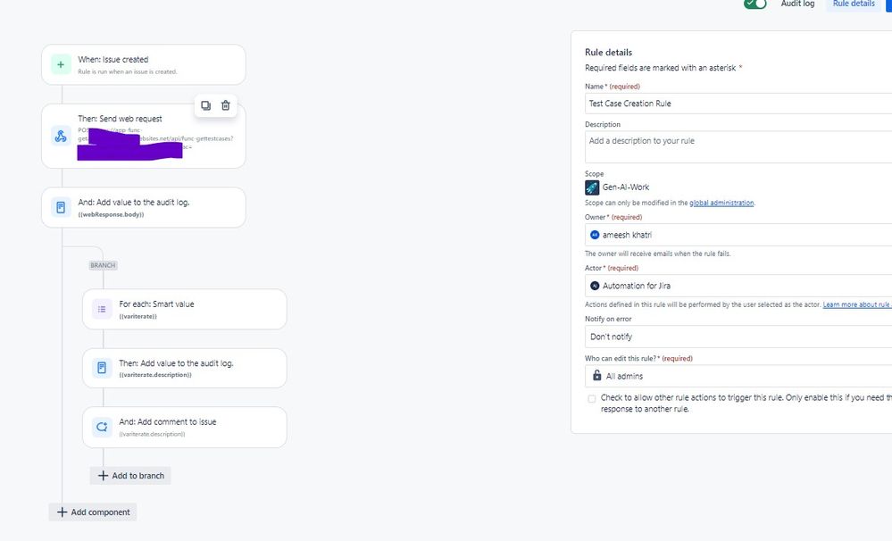

Hello @Kalyan Sattaluri , Below is the complete audit log which you requested. I have changed the rule as per your suggestion with {{webresponse.body}} . Though you see the first box of rule in the snap has clipped, but to fit the entire snapshot I did my best to get the entire snapshot. The first step in the rule is the "send web request" only.
Apology, if you find multiple screenshots without comments before, but my machine has some slowness so my previous replies were just screen shots.
Here two snapshots, rule details and audit log respectively. Even after using webresponse.body "variterate.description" doesnt provide any value.

My rule is like below, (as I have suggested to you):

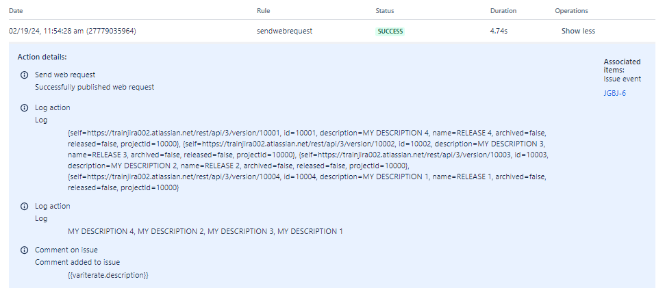

Then my audit log is like below: (notice I am logging {{variterate.description}} inside branch so I know value is getting populated)
My Final Output is like below:
Your JSON structure is no different than what I have.
That is why I asked you to LOG the {{variterate.description}} inside the branch as well, which you dont for some reason.

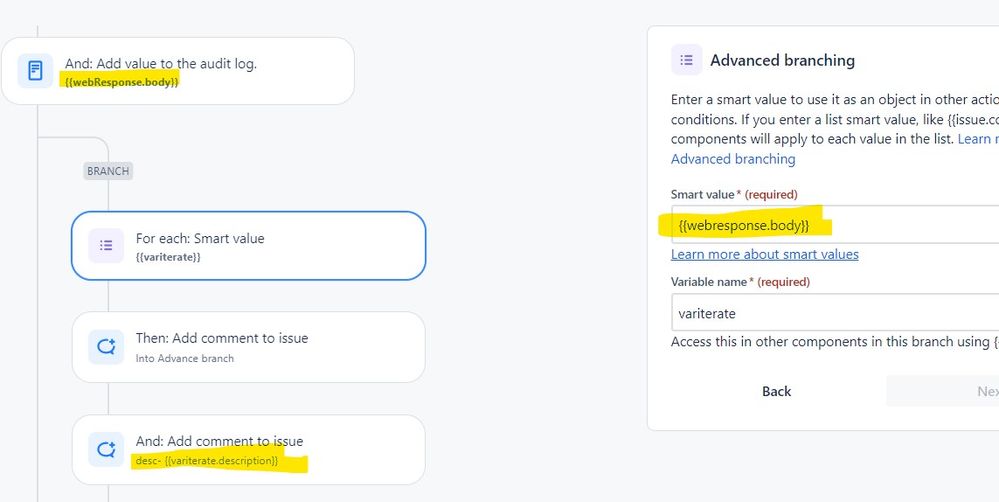

@Kalyan Sattaluri  I replicated the way you created the rule and have seen the rule is failing because {{variterate.description}} is getting blank. Absolutely frustrating for me :(
Here are the latest snapshots:
Yesterday when I ran {{webResponse.body.size}} it shows blank as @Bill Sheboy  asked to check which means there is definately problem with JSON list like response coming from the service.
If the iteration rule doesnt work I need to check match() or string functions which I have to explore it.
Kalyan Sattaluri
February 20, 2024
@Amish Khatri @ameesh khatri
Maybe its those leading and ending square brackets making it JSON array which Jira is not able to parse. I can think of 4 different options of varying complexity.
  1. Try to send this web response you have received to an incoming webhook unchanged and see if Jira can parse it. To do this, create a new rule with trigger as incoming webhook, grab the URL and then, in your existing rule, once you have made the web request, send this {{webreponse.body}} in payload to the URL, and finally, in the new rule, check {{webhookData.size}}
  2. Same as above, but before making the call to webhook, remove the leading and ending square brackets, like {{webreponse.body.remove("[").remove("]")}} because they seem to be the issue. And check if you can parse the JSON.
  3. As @Bill Sheboy has suggested, you can parse the text and extract your values. See HERE for example
  4. Finally, see if you have another end point which gives same data but in a JSON which Jira can parse.
I would make sure #4 is an option, if not, quickly check  #1 & #2 if they work, if not, you can solve it by #3.
