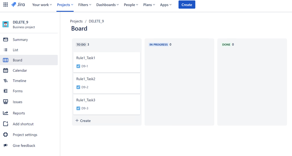

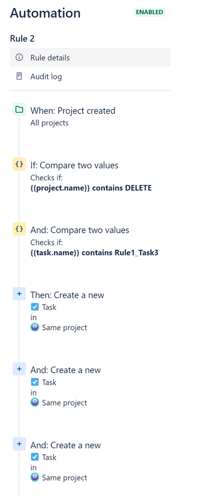

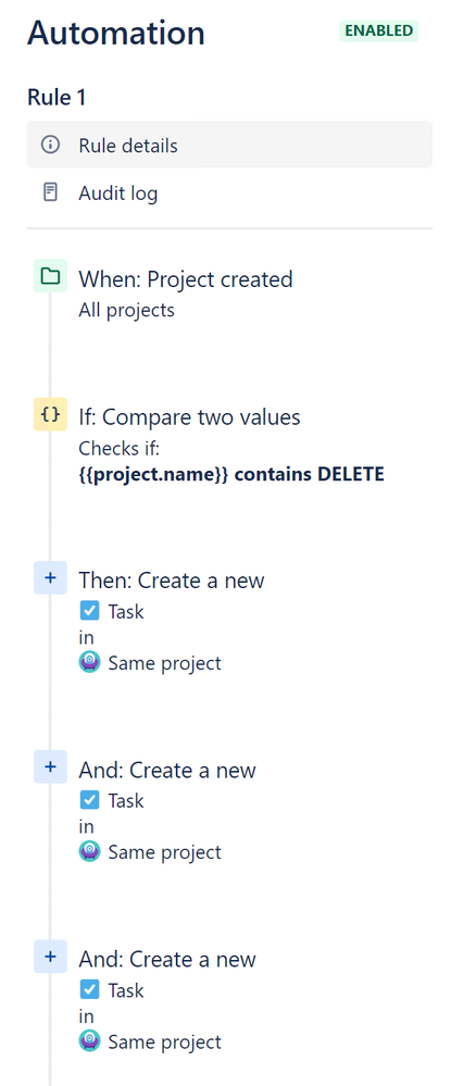

I created sample rules: "RULE 1" and "RULE 2".  However, when I tried to create a project, only the Rule 1 was executed.  I'm sure my syntax in Rule 2 condition is incorrect.

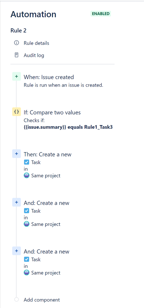

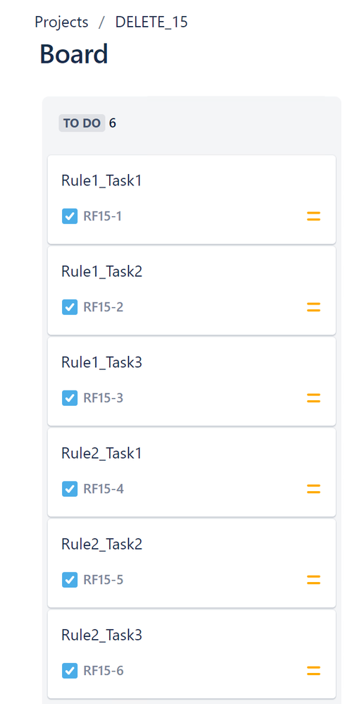

I created a sequential rule by looking at the {{issue.summary}} and it successfully made tasks in order.
Thank you for your help!Screen Shot 2021-12-05 at 7.57.40 PM.pngScreen Shot 2021-12-05 at 7.56.05 PM.png
