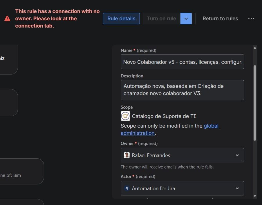

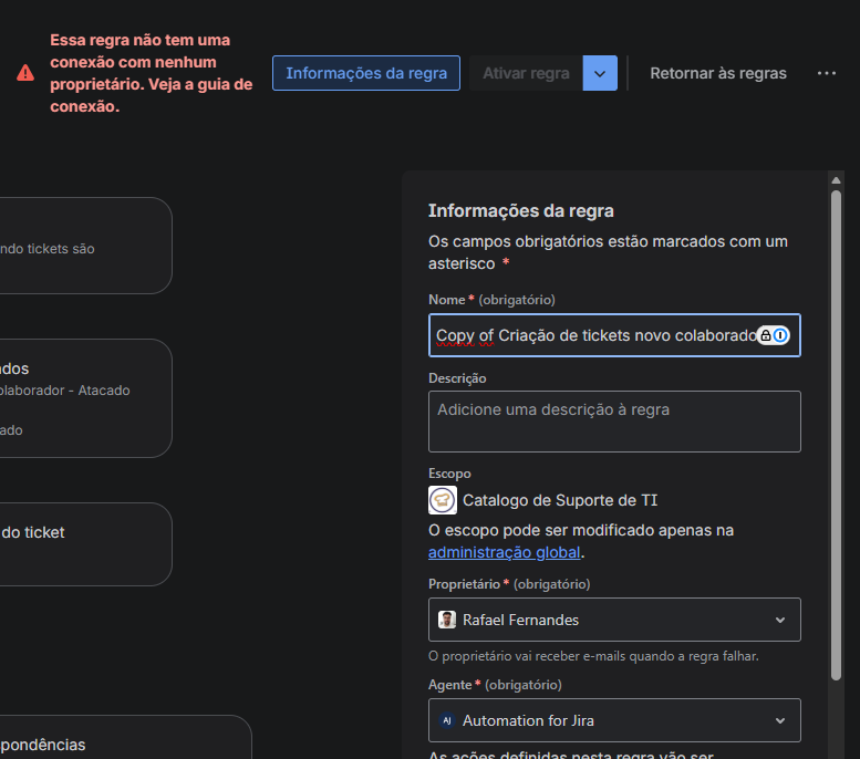

This rule is not connected to any owner. See the connection guide.
But, the rule have a owner.
I've already tried changing the rule name and the owner, but it didn't work.
The screenshot below, which is in English, shows an error with a different automation."

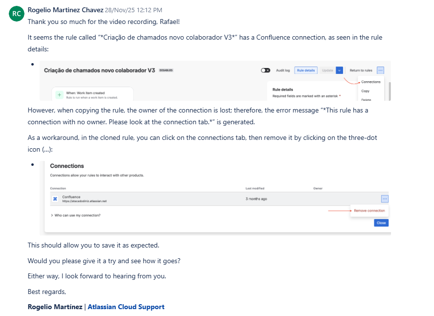

The response from Atlassian support. I followed the step-by-step instructions and it worked.
Glad its resolved.
BTW, you didn't mention this rule was connected to Confluence, this had been essential information.
I assumed the rule was relating to Jira

I think the author's first two sentences are a translation of the message in red text in the upper left corner of the image they shared. And in the lower right portion of the image we can see that the owner field is already set.
So the question may be why is the error appearing?
In screenshot, i am the owner in the automation.
