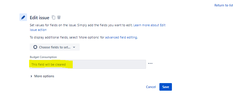

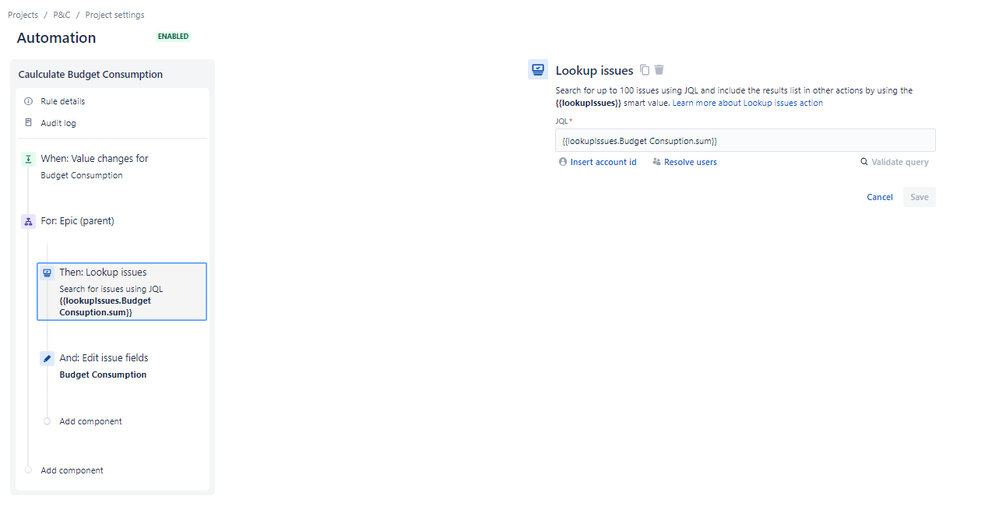

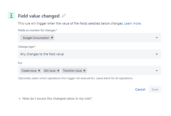

Could anyone please advise what am I doing wrong?
The idea is to be triggered everytime Budget Consumption is updated on a Task level and updated to Parent Epic_Budget Consumption...
Trigger details
Lookup issues
Edit Issue Field
Currently, as a result when Budget consumption updates on Task it clears the field in Epic. Will this have to do with OOTB setup?
Many Thanks
Marina

Curt Holley
August 16, 2023
I think in the edit issue field you want to have {{lookupIssues.Budget Consuption.sum}}

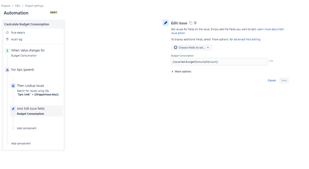

Marina Koga
August 23, 2023
Thanks for you comment, is the below aligned to your suggestion? If so , this current rule is not rolling up to parent (epic) as expected.  Are you able to confirm? Many Thanks

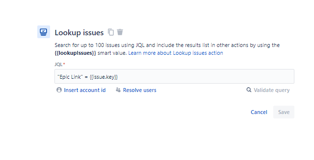

Curt Holley
August 31, 2023
@Marina Koga You don't want to put {{lookupIssues.Budget Comsumption.Sum}} as the JQL for the lookup. You need to put that in the Edit Budget Comsumption action.
You put the JQL that will provide the content in the look up

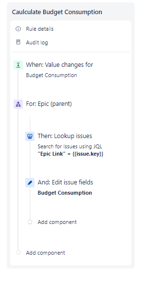

Hauke Bruno Wollentin
August 15, 2023
In your branch rule you need the smart value {{triggerIssue.[...]}} instead of {{issue.[...]}} to get access to the fields of your Task and not your branch Epic.

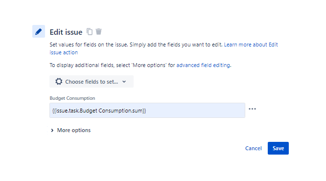

Marina Koga
August 23, 2023
Thanks Hauke,
Are you able to confirm if the below setup is as per your suggestion? This still not working and i believe i am missing something (being new on this, appreciate your help and patience).
Many Thanks
August 30, 2023
I'm not 100% sure since I never had the case you described, but in the official documentation I can't find any function ".sum" like you used.
But still there are some math functions available that you could try out.
https://support.atlassian.com/cloud-automation/docs/jira-smart-values-math-expressions/
To be honest, since we have bought ScriptRunner I typically use Groovy to perform such calculations, but maybe it is possible by Jira Automation + Smart Values at all.
