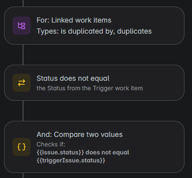

To avoid this resynch, I tried to add an if statement in the branch, but for some reason the automation will always pass on that if statement and try to update the status for a 2nd time.

I had added a smart value if statement and that one seems to trigger correctly
It would probably be helpful to understand why these 2 if statements are not the same, however I can work with this

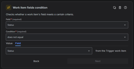

Can you provide a screen image showing the details of the "Status does not equal" component?

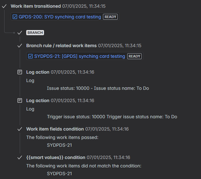

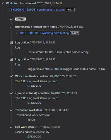

Log when status field on both work items are different:

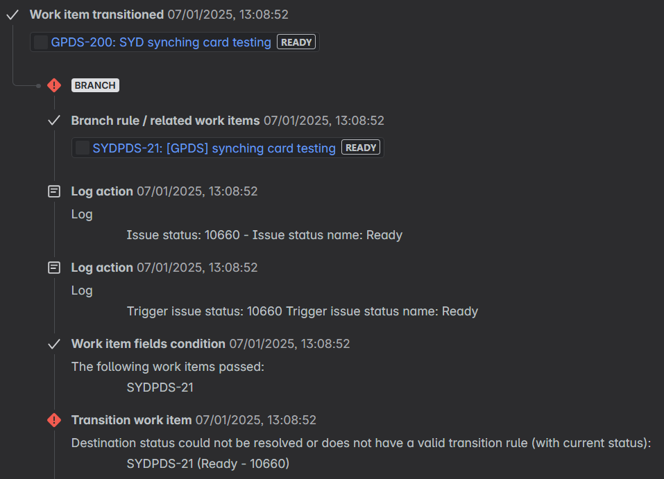

Log when both items are the same (runs automatically again because last action of previous run, makes it run again)

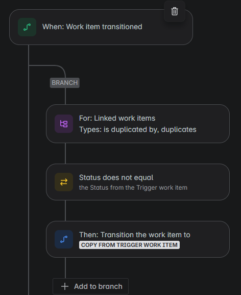

Config of the work item field condition check which passes in both runs above

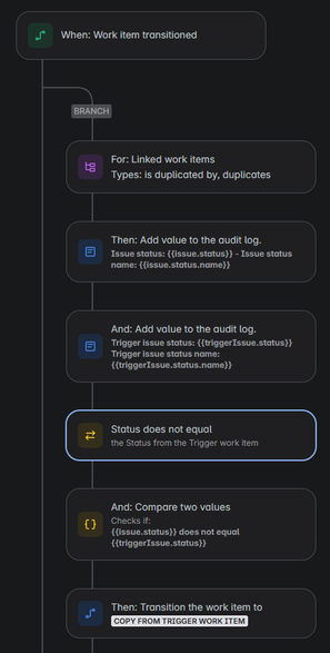

Automation rule:

Would you consider doing another test removing the smart value compare to see what is reported?
As it stands now the work Items Field condition and the Smart value condition are getting the same results. I would like to see if removing the smart value condition will result in the problem occuring again. If it does then I would suspect a timing issue where the rule is running before the data is truly saved in the database.
in the case where the status values are different, both conditions show a different result.
The work item field condition shows it passes, the smart values condition says it does not pass...

When #4 occurs (the second rule is triggered again by the transition that it executes) the Work Items Field Condition used within the branch to compare the Status of the linked issue to the Status of the Trigger issue is not detecting that the Statuses are the same. But the Advanced Compare condition does detect that the statuses are the same.
We know that the rule will work as intended when the Advanced Compare is used.
