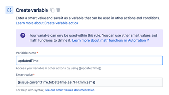

At this point I am getting some success by concatenating the summary in the following way:
Edit issue action:
{{summary.match("(.* at)")}} {{updatedTime}} {{summary.match("(:00.*)")}}
I've successfully extracted the "13:30" from original summary (as described above) into a variable {{currentTime}}, but right now stuck on converting the "13:30" into a dateTime object so I can use a time function on it (minusMinutes(30)) and assign to variable {{updatedTime}}
The following is not working, as trying to log {{updatedTime}} always comes up empty. Any suggestions?
