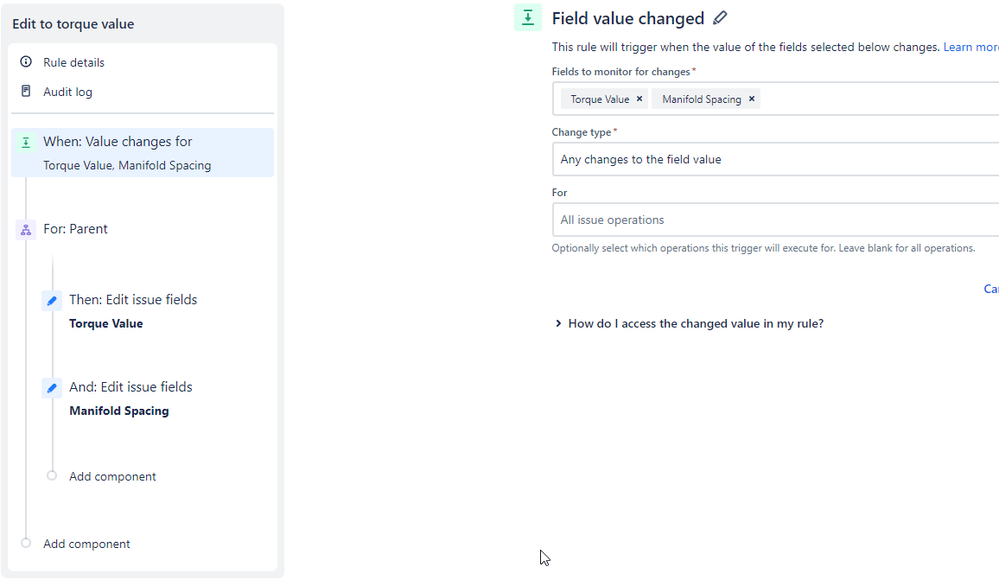

So I've started to play with the automation and it works, kinda, but unless I/we can come up with something clever I will need a new automation per value to update. Because as listed below if I have multiple things trigger but not all the values updated from the same subissue the non-updating value is blanked out.
Bill Sheboy
December 8, 2023
This is where conditions will help, allowing you to test if the value is non-empty (or changed) before the copy.  I added links to help explain how to do the specifics.
Before that, we need to confirm the smart values for your custom fields.  Smart values are name, spacing, and case-sensitive, and often do not exactly match the name displayed on the issue views.  This how-to article will help to find them: https://support.atlassian.com/cloud-automation/docs/find-the-smart-value-for-a-field/
The steps are:
  1. identify an example issue with your fields
  2. call a REST API function with a browser tab
  3. search for your field on the page, such as with CTRL-F (find)
  4. that will show the correct smart value (and custom field id) to use in your rules
Back to your rule...let's assume if the field value in the subtask is changed, you want that value updated in the parent.  And so the pattern of the rule would be this:
  • trigger: value changes for Torque Value or Manifold Spacing
  • condition: issue type equals Subtask (This is missing from your current rule)
  • branch: to parent
  • branch: to parent
    • advanced compare condition: (using conditional smart values)
      • first value: {{#if(exists(changelog.smartValue for Manifold Spacing))}}changed{{/}}
      • condition: equals
      • second value: changed
    • action: edit issue, changing only the Manifold Spacing, to copy from the trigger issue
    • action: Re-fetch issue (This will reload the data before the rule proceeds)
