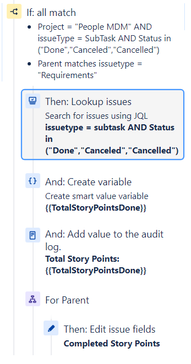

Hi -
To save reading time I am stating up front that we are using Cloud Team Managed projects and do not have scriptrunner (nor is it likely to be installed in the future).
Background: We have created an issuetype 'Requirements' and have subtasks that, once completed,  would satisfy the Requirement. Weekly we have to report our progress to the Stakeholders at the Story/Requirement level. Currently we grab the latest subtask due date and total up all the subtask story points into the fields at the Requirement level.
What we are struggling with is the ability to find all the 'done' tasks under the requirement, total the story points up and place that number in a custom field on the Requirement/story level called 'Completed Story Points'.  From there we can report the percentage done to align with the graphic at the story/requirement level by doing some calculations.
Challenge:
To be safe until fully tested, this is a manually triggered automation at the subtask level. This triggered subtask was done and had 2 story points. Another subtask had 1 story point and was also done. The remaining subtasks (2) were still in other states of progress so should have been filtered out. I therefore expected a result of 3
1. The If filter is already narrowing the issues to subtasks that have a Requirements issuetype as a parent in order to filter out other parents that are stories, tasks, epics etc.)
2. My assumption was that I needed the lookupissues task in order to create a list where I can total up the story points of only the stories that are done so I replicated the JQL which I thought should be the resultset from the If: all match.
3. Once I get that list the total would be stored in a variable for use in the Parent.
The result totaled all story points across the project that were done (147). The log entry of 6 was all story points whether done or not in the triggering subtask.
I have tried many iterations of automation without success and am asking for assistance.

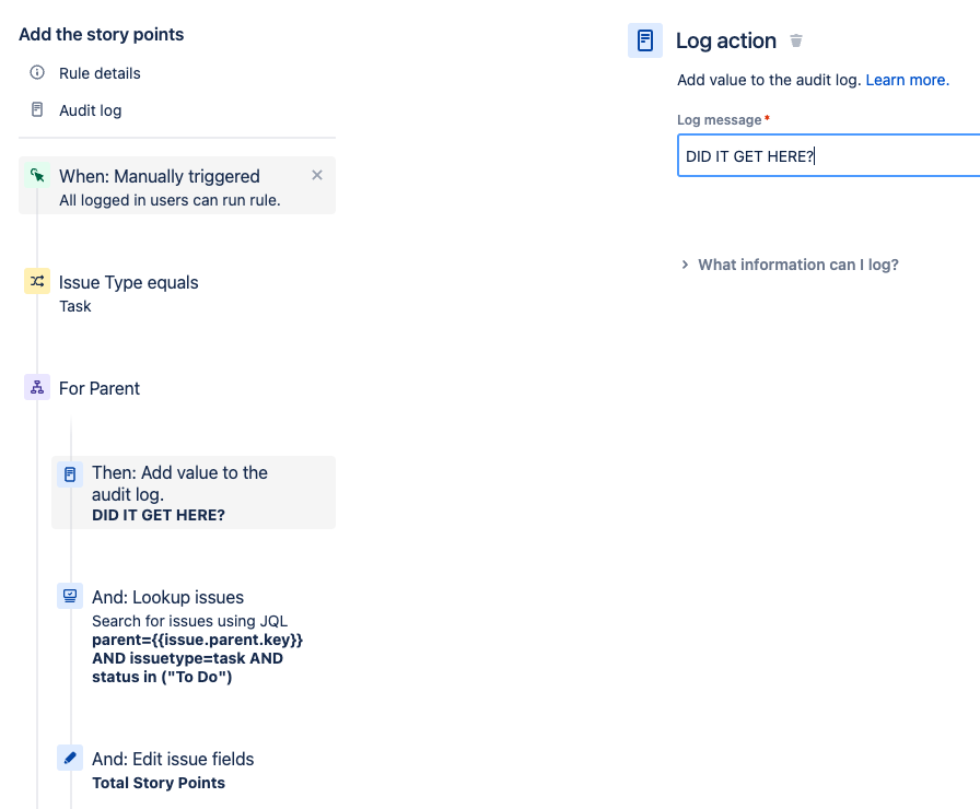

Darryl Lee
November 22, 2022
Hi - I think the issue is that variables in Automation are scoped locally, so your {{TotalStoryPointsDone}} doesn't even exist within the Parent branch.
What I would try is to Edit the issue field for the Parent and put in directly:  {{lookupIssues.Story point estimate.sum}}
Darryl Lee
November 22, 2022
This is not quite right. I'm still working on it.
I think the variable thing may be right, BUT ALSO, your JQL query does not scope the results to only subtasks of the PARENT of the current subtask.
Darryl Lee
November 22, 2022
WELP, I spent a lot of time on this, and I feel like this should have worked, but it weirdly never makes it to the Parent block (my "DID IT GET HERE?" message never gets logged), so literally have no idea why this isn't working but I suspect it is some Team-managed Project weirdness.
Any thoughts, @Bill Sheboy ?

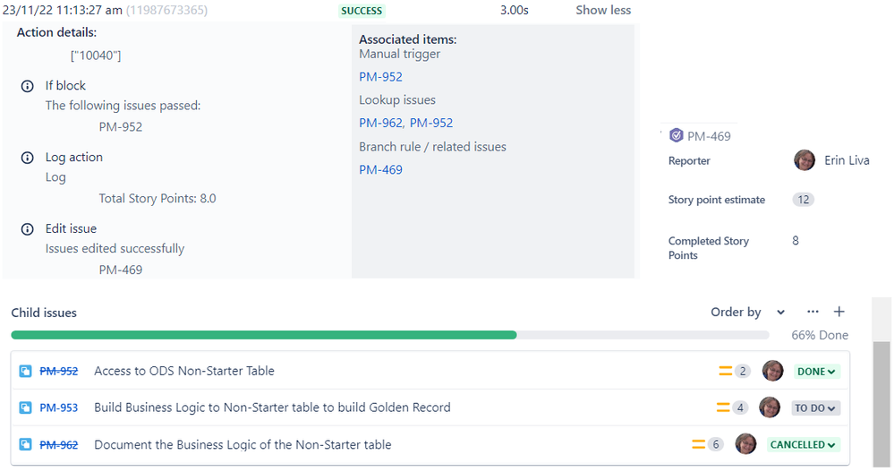

Erin Liva
November 23, 2022
Hi @Darryl Lee
I can't use {{lookupIssues.Story point estimate.sum}} in the Parent because it will automatically sum up all the story points for all the subtasks whether they are done or not.
Based on earlier answers, The IF: statement is not like a programmers version where it reduces and then passes the filtered dataset result so thinking I don't need this and should only use Lookupissues since it ignores what was previously filtered?
Is there a way in lookupissues to say:
Project = "People MDM" AND issuetype = 'subtask' AND status in ("Done", "Cancelled") AND [Parent matches issuetype = "Requirements"]?
Then I could possibly get the list of the completed subtasks under that Requirement (Story) and count the story points?

Erin Liva
November 23, 2022
Yippee! Thank you. That worked :)

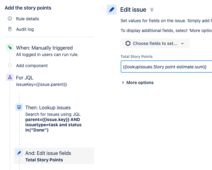

Darryl Lee
November 23, 2022
Hi @Erin Liva so glad you got it working. Would you mind sharing your final rule? For some reason I had problems with the Parent related branch, and only was able to get it to work with a JQL related branch that seems to do the same thing.
Perhaps it's because I'm using a Manual trigger instead of actually off of a field change. In production you said you're triggering off of your subtask being completed, and in my example I'd be triggering off of tasks being completed.
Anyways I think {{lookupIssues.Story point estimate.sum}} will work because the Lookup filters for only tasks that are Done (this is a change from my earlier test rule).
And {{triggerIssue}} might be better to be very explicit about which issue we're talking about.
Here's what seemed to work for me:

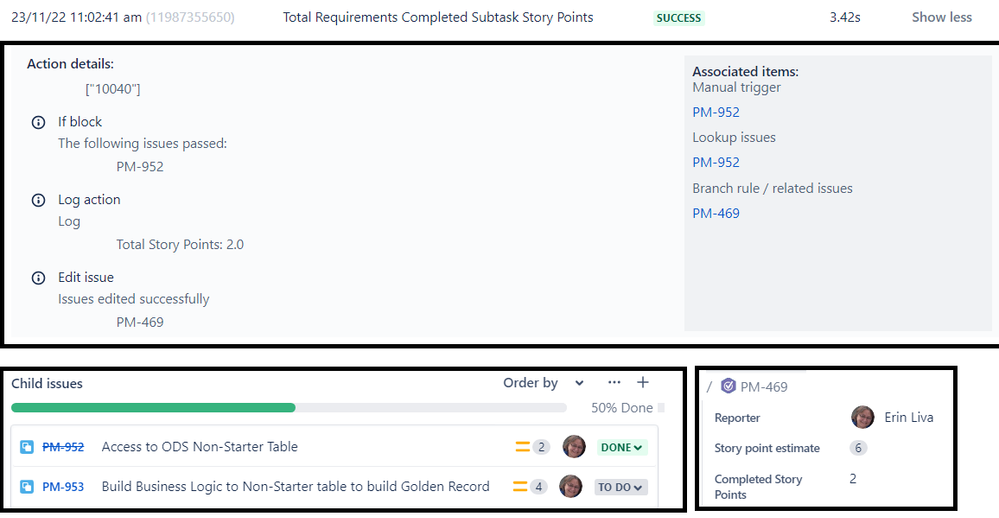

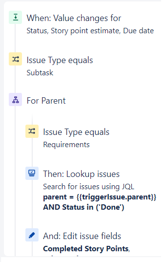

Erin Liva
February 27, 2023
@Darryl Lee I couldn't find a place to send you a message on the rule. I finally decided to go ahead and post on the closed issue. Can you please let me know if there is a better way to send you things vs. reattaching here?Sum all subtasks done in Requirement story.png
